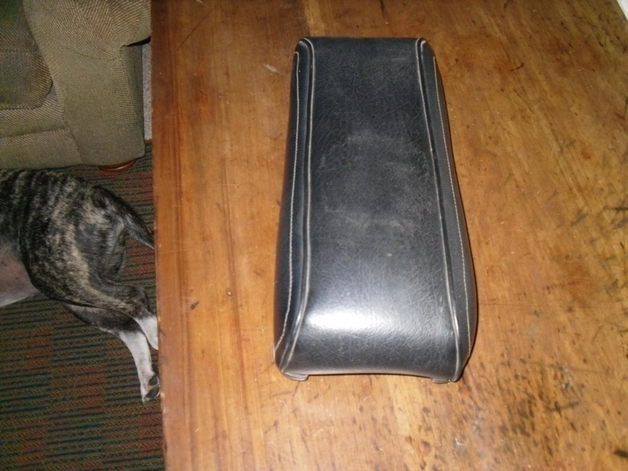

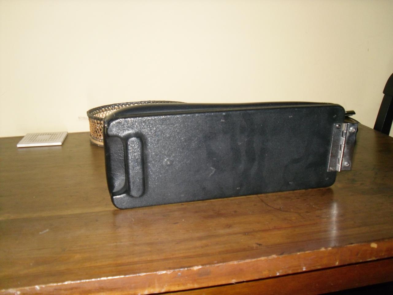

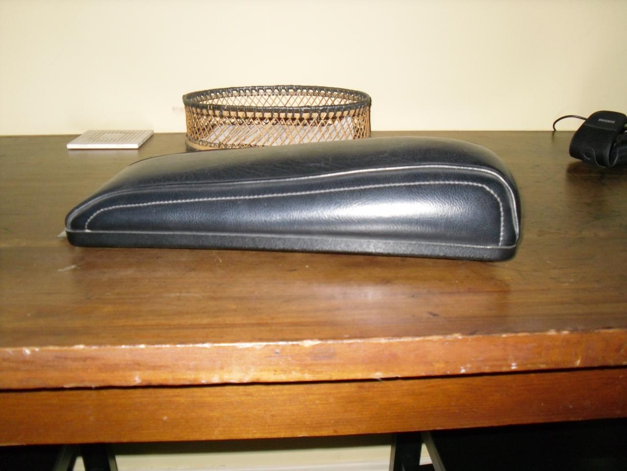

I still have my old 77 console that opens from the side sitting in the basement, I just cant seem to throw anything away including the old door panels, they were in good shape other than the speaker holes the P.O. hacked into them.
