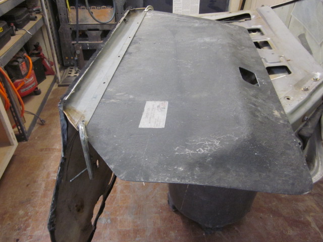

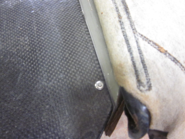

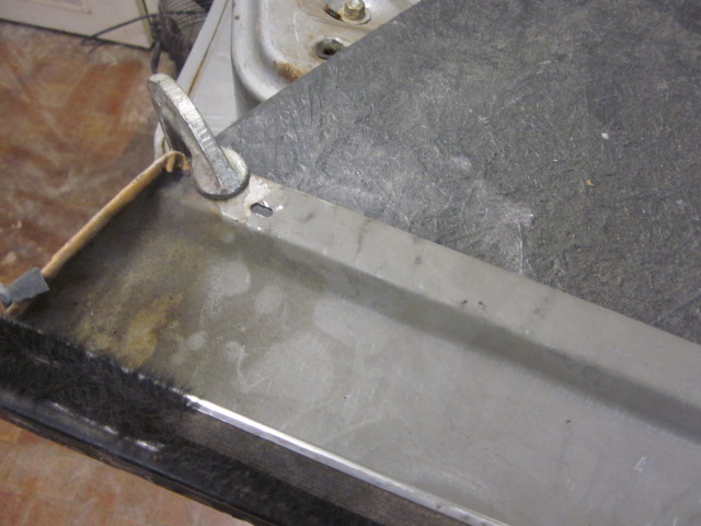

Jack, the hardboard is shaped so I doubt that most guys with garage skills would or should attempt it. But there is a guy in the Bay area in California who has recreated the hardboard section in fiberglass. Strictly510 is the name of the business but I don't think he is web based. He hangs out mostly at HybridZ and his screen name is Rayven something... I used that method and here are the pictures...
First, you have to cannibalize a pair of doors for the metal tops. Then, you rivet the metal top to the fiberglass panel. At this point, you test fit to the door and drill holes and router them to the proper shape. I used some GM plastic panel rivets to attach the panel to the door. Finally, once you have everything drilled, you apply the vinyl and rivet the fuzzy to the window side. Not that hard but more expensive than buying new panels which as has been said, pop up from time-to-time...
Cost:
Fiberglass panels - $250 + shipping
Vinyl - $250 + shipping from Classic Datsun Motorsports
Various small costs include: upholstery foam, contact cement, rivets.

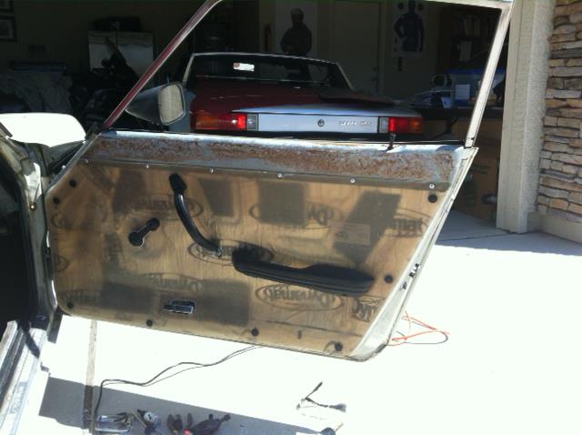

Those unfortunately, are hard to find in good condition... i.e. no speaker holes, no tears, snags, or puncture marks, and lastly, with the chrome strip still showing chrome. Additionaly the original hardboard is infamous for soaking up humidity (that's why there's a vapor barrier) as well as having the clip holes tear out of the edges when being removed. That's why the fiberglass backing is such a good deal.
Expect to pay UPWARDS of $400 or more dollars for a set of Interior Door Panels in good condition. In excellent condition.... probably double that.
Sometimes.... yes sometimes, a set will pop up on e-bay or Craig's list that is in good to excellent condition... then the bidding will go through the roof. Be sure to take a close look at any pictures as there have been surprises when the item gets delivered.
