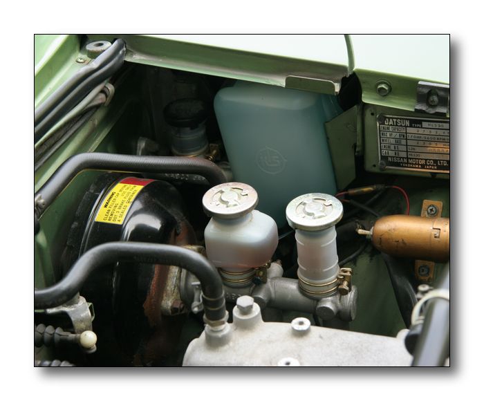

I am not an expert, are the mounting holes the factory ones or was it modified. Mine is a 72 and she came with a 71 booster, a 72 booster will not fit on my Z existing holes, a 280Z booster is a popular mod but does required re-drilling mounting holes................FWIW
Edited by 72 OJ
If you replace it, beware that your piston length may be different. I remember doing this quite a number of years ago and used a later model booster. I quickly discovered the piston length difference when my brakes didn't work !! Anyway, my point is to make sure you buy both the booster and the piston if you end up replacing it.
