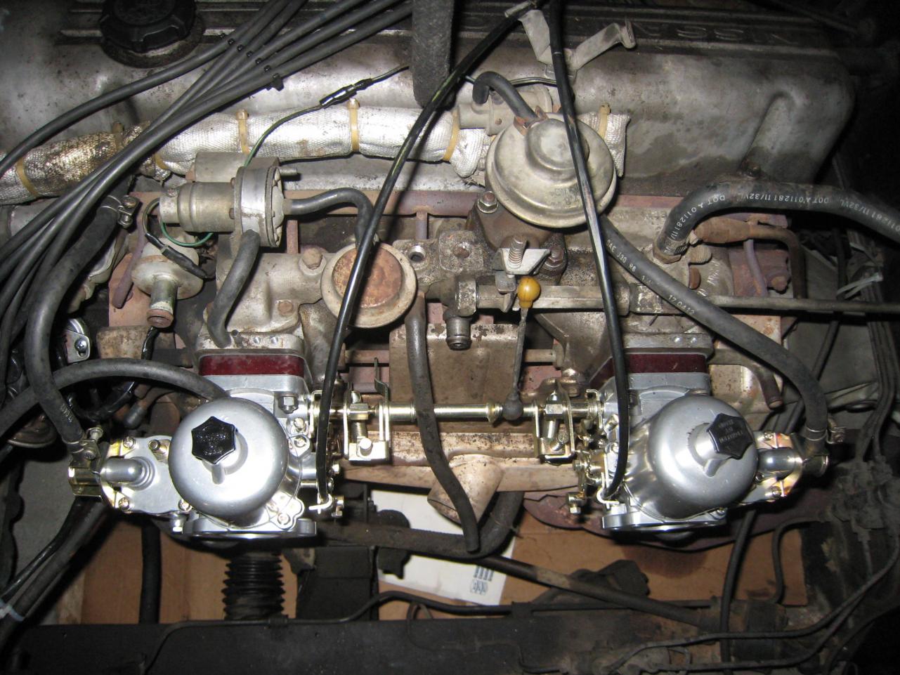

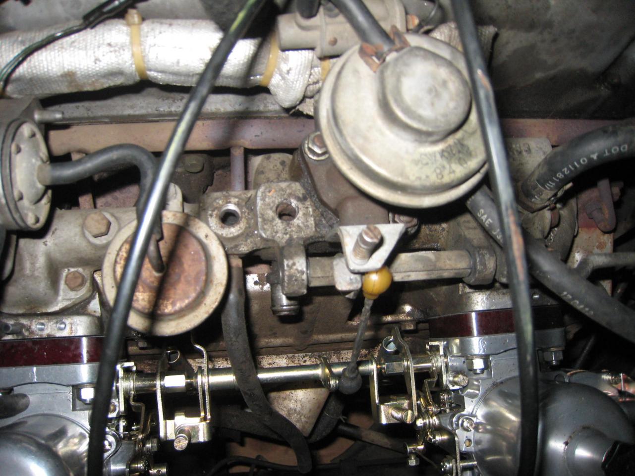

So I have a stock 73 240z with all the original frankenstein'd pieces in the car. I recently purchased ztherapy round top carbs to replace my old flat tops. The car can start and idle but I'm having issues with the old balance tube. It's an n33 balance tube and n36 intake manifold. It still has all the old EGR equipment but it can't be used since theres no where to mount return wires on the new round top carb. Can anyone help me figure out what parts I can plug up/shouldn't mess with? It's beautifully overwhelming haha. Thanks guys!

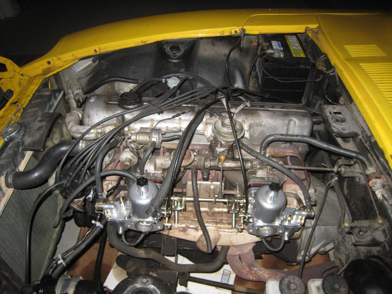

I took off two ports as seen in the 5th pic, I'm not quite sure what they did. Wasn't the greatest idea to copy a picture I found on the forums, but I'm going to plug them up. Or should I? Anyone have a picture diagram/write up I could follow?
Start by plugging the vac port on the front manifold behind the isolator. Next hook the crank case vent to the PCV (balance tube center). put the air cleaner back on the car, these carbs need a filter to increase the manifold vac to run if they aren't properly tuned. Cap EVERYTHING that isn't being used on the manifold, and hook up the hot water circuit to the manifold, if you let everything get up to temp it will run better..
My 73 wouldn't run off idle when I did the conversion at first untill I put the air filters on and dialed the carbs in from there. Once I got them really close I was able to take the filters back off and fine tune the carbs.

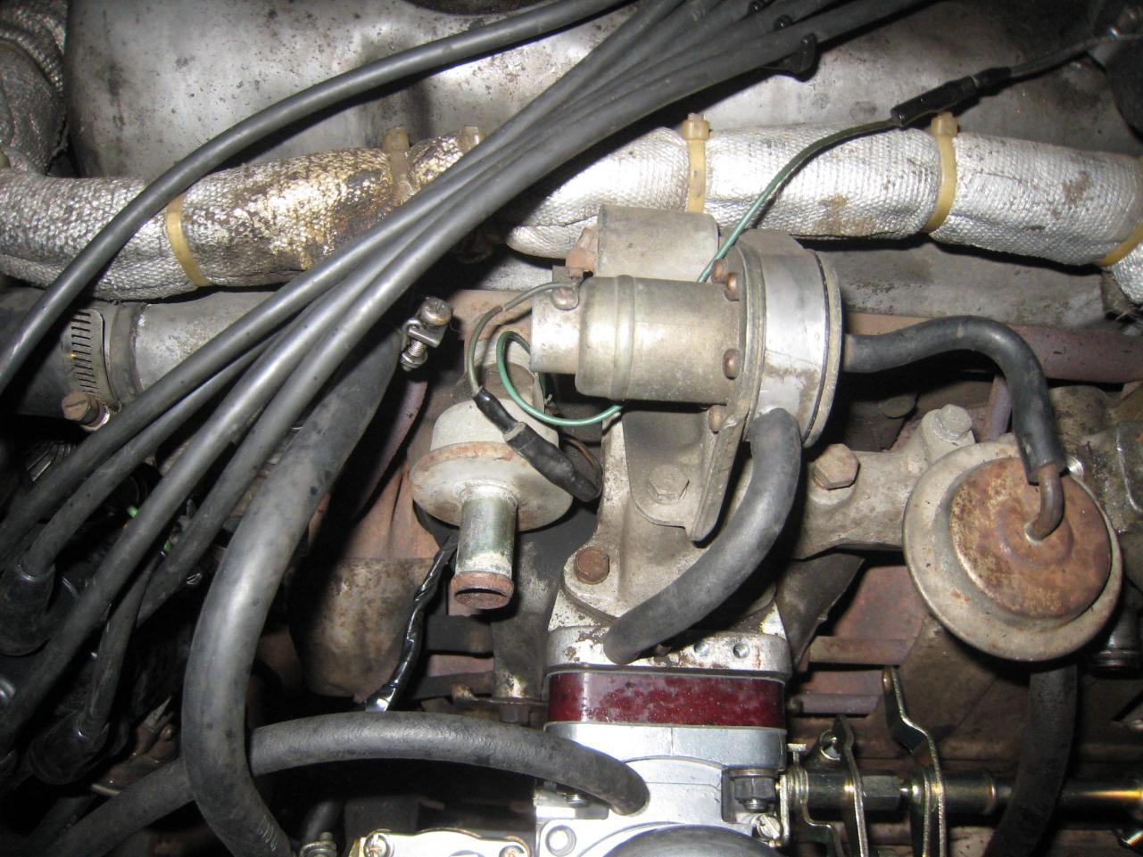

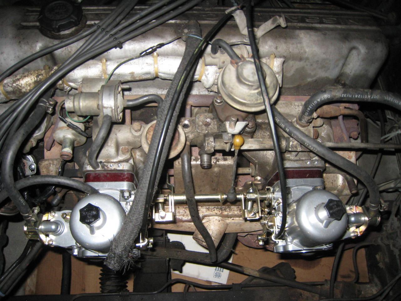

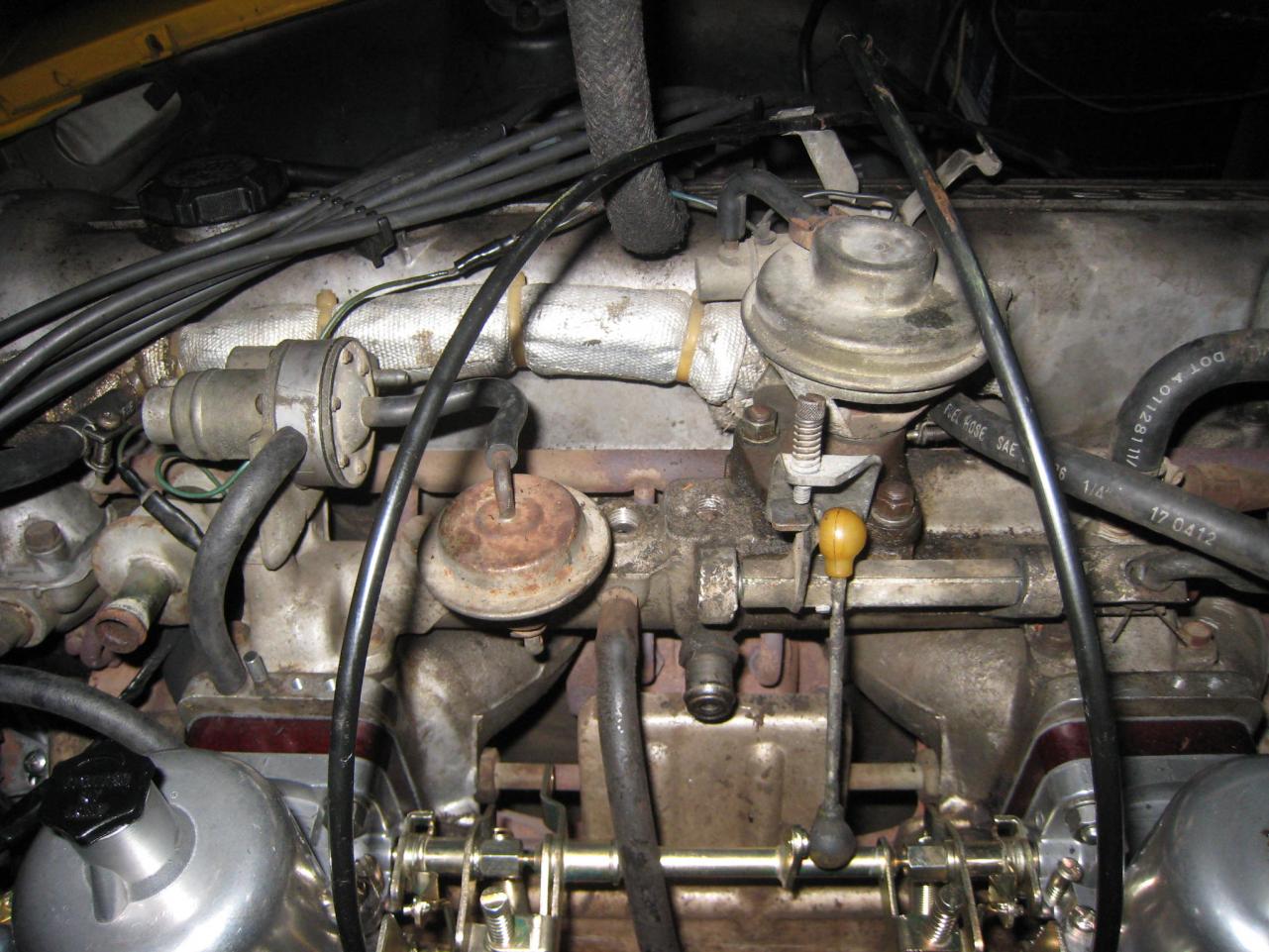

Looking at your pic (3468), I see a whole bunch of disconnected stuff, but I'm only going to talk about the ones that would cause you big problems:
1) Vacuum port on the front manifold just behind the carb - Used to go to your vapor reclamation system. If I were you, I would reconnect your flow guide valve, but if you choose not to, just cap that port.
2) Holes in the top middle of your balance tube - The one on the left used to go to your anti-backfire valve. If I were you, I would reinstall an anti-backfire valve system and use the port as part of that system. Look for pictures of an earlier round top car for how to connect the anti-backfire system.
3) Holes in the top middle of your balance tube - The one on the right used to go to your idle air control system from your flat tops. You don't get an idle air control with your round tops, so you can just plug that port.
4) Black hose coming out of the balance tube below the two ports mentioned above - That used to go to your temperature controlled idle mixture compensation valve. You don't get that privilege with the round tops, so pull that hose off the balance tube and cap that port.
5) Short nipple sticking out of the balance tube below the two ports mentioned above - That's your PCV valve and it should be plumbed to the crankcase under the distributor near the front timing cover. There's a black braided hose sticking down towards your exhaust manifold... That may be your PCV connection hanging down there.
6) Your EGR stuff is still intact, but it's not doing anything. It is currently disabled and will have no effect.
There might be more going on than I see with the above, but look into the above and see what happens. If there's any in particular item you want more info on, just ask.

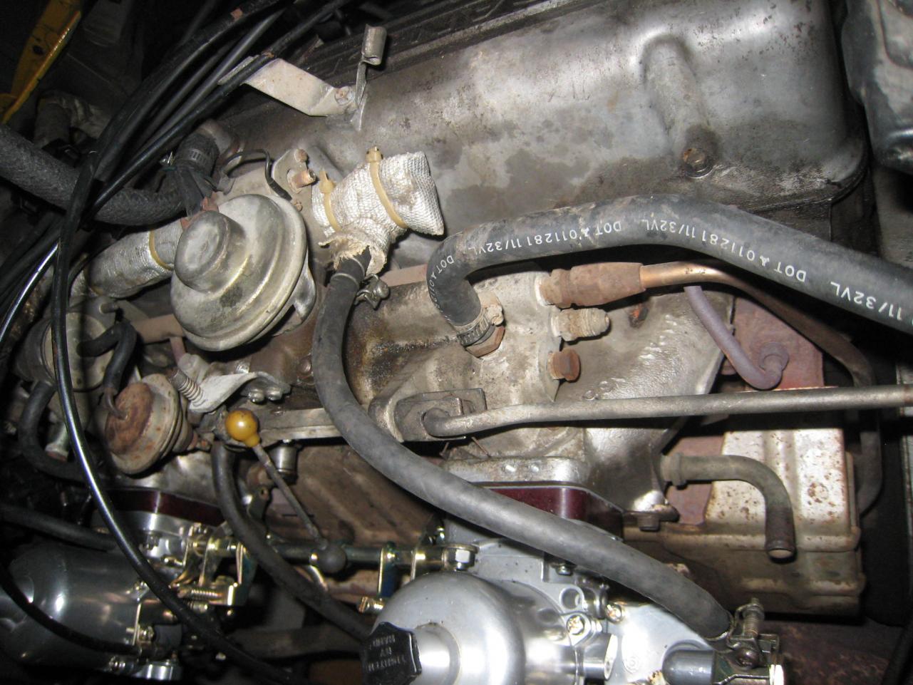

It's a metric thread, just a little smaller than the MIP thread. I don't remember the exact size and pitch but you wont find these in many hardware stores, I got some at an automotive shop that deals with japanese performance motors. Might try the Nissan Dealer.
just found out theres no such thing as m13, it's funny because this doesnt fit m12 or m14...oi this car.
All of those designations you are using (M10, M12) are for straight threads. The hole you are trying to plug is probably a tapered thread (not a straight thread) and if that's the case, then none of those "M" size designations are the right ones.
That aside... My suggestion for any of the holes you are trying to disable would be to screw the original nipple back into the balance tube and then use a rubber cap for the nipple. Might not be the prettiest solution, but get the bugs worked out first, and make it pretty later if you still have any money left.
1/8" NPT works OK for the vac holes but it's not exact so use some teflon tape. BPT (British Pipe Thread?) is the real deal - how do I know? The Search feature on the home page. My 73 is slightly different I think. You have an automatic I'm guessing from that steel vac tube on the back. Most people get rid of all that junk from the cars I've seen. Some of those holes aren't vacs, leave them open or put a stainless metric bolt for looks. That cast iron thing has to stay unless you do something else to support the fast idle screw, I don't like it - got the rest shined up. The flying saucer thing on top of it can go. Maybe that junk is worth some money?
Those carbs look sweet but now the balance tube sticks out like a sore thumb. Fortunately the balance tube comes right off (seal the gaskets when you put it back). A half hour work with a soft wire brush, then a bunch of aluminum polish and buffing ....
