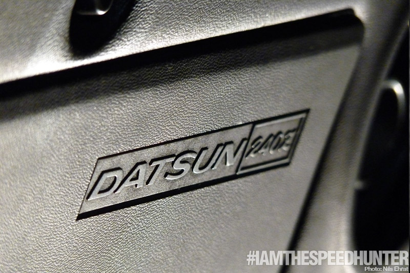

Well haha, a Picture uf my Zed's glovebox i made at the beginning of my project was featured in the #IAMTHESPEEDHUNTER Programme Detail theme on Car Culture at Large - Speedhunters and i'm very proud of it, beeing a daily Speedhunters reader :)
