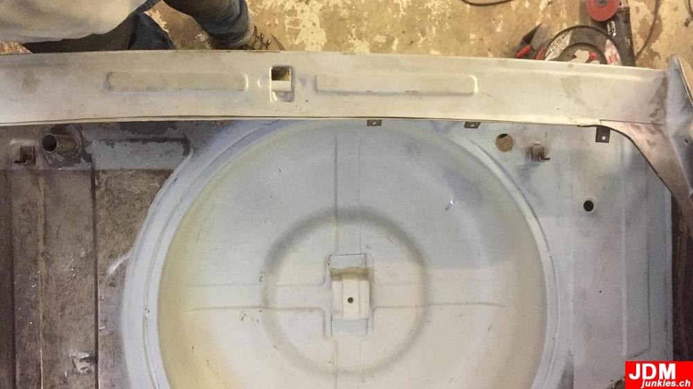

Got some more news from my bodyshop. Nothing big, but another step closer to a finished shell. The spare wheel well is back in and primered with rust protection and also sealed:
WhatsApp-Image-2019-12-16-at-17.41.20-Ko
WhatsApp-Image-2019-12-16-at-17.42.23-Ko
WhatsApp-Image-2019-12-16-at-17.41.08-Ko
Edited by JDMjunkies.ch

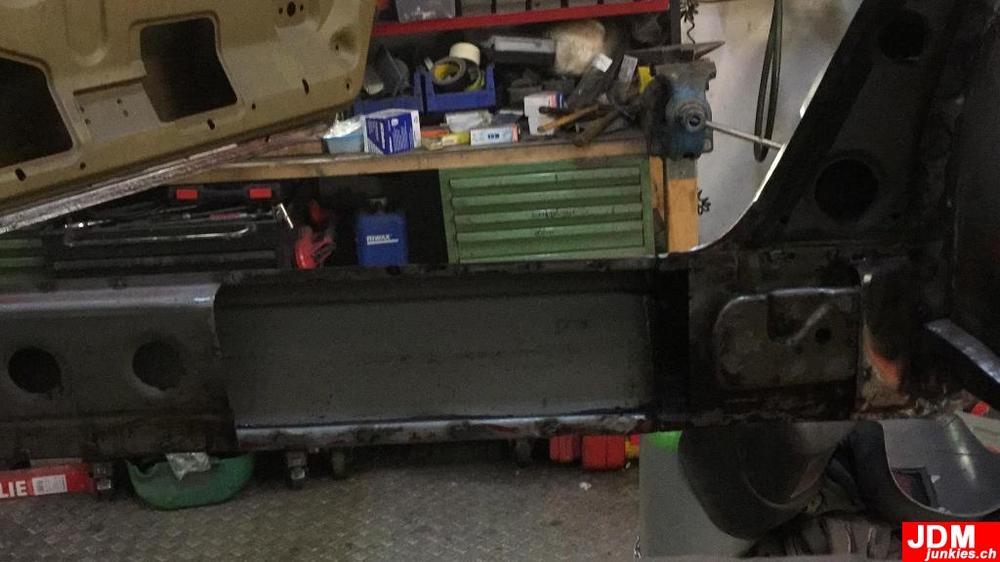

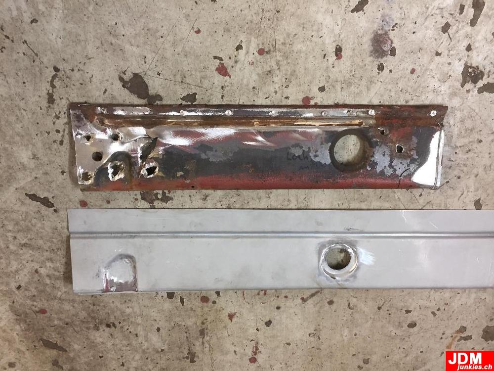

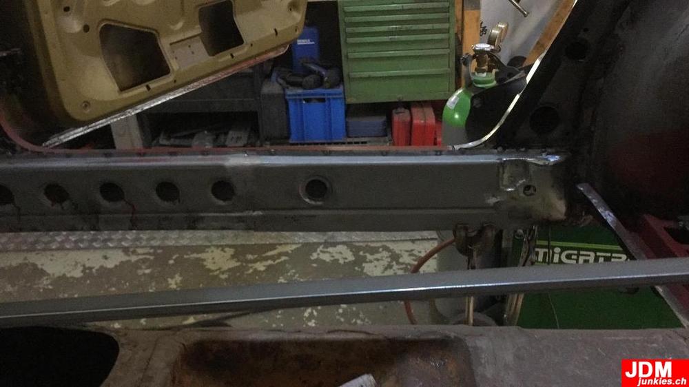

Just another update from my Metal-wizard. The driver side lower frame has been cutout
WhatsApp-Image-2019-12-17-at-17.00.33-Ko
A new piece has been fabricated
WhatsApp-Image-2019-12-17-at-17.00.42-Ko
And now it's back in. I guess the next big part will be the LH rear quarter and inner wheel well.. I'll go to have a closeup look soon ?
WhatsApp-Image-2019-12-18-at-16.55.55-Ko

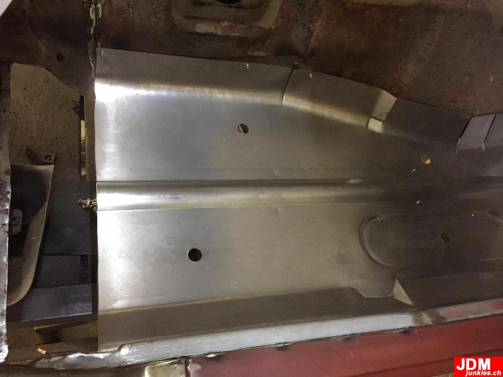

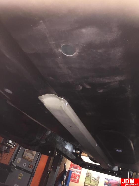

So, My panelbeater started work on the passenger side floors. Those hungarian-made floor pans came in.. before:
WhatsApp-Image-2019-12-20-at-12.01.03-Ko
After: Still have to be welded etc. but overall fitment looks nice.
WhatsApp-Image-2019-12-20-at-12.01.02-Ko
Here is the bottom side fitment together with the NOS frame rails. Seems pretty spot-on!
WhatsApp-Image-2019-12-20-at-12.01.04-Ko

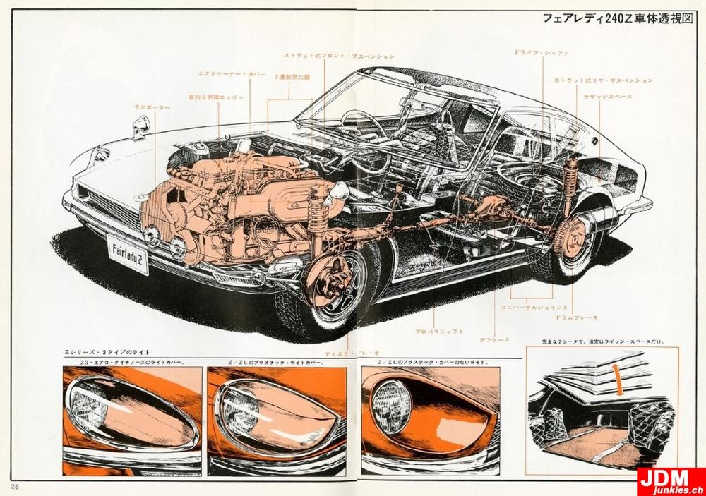

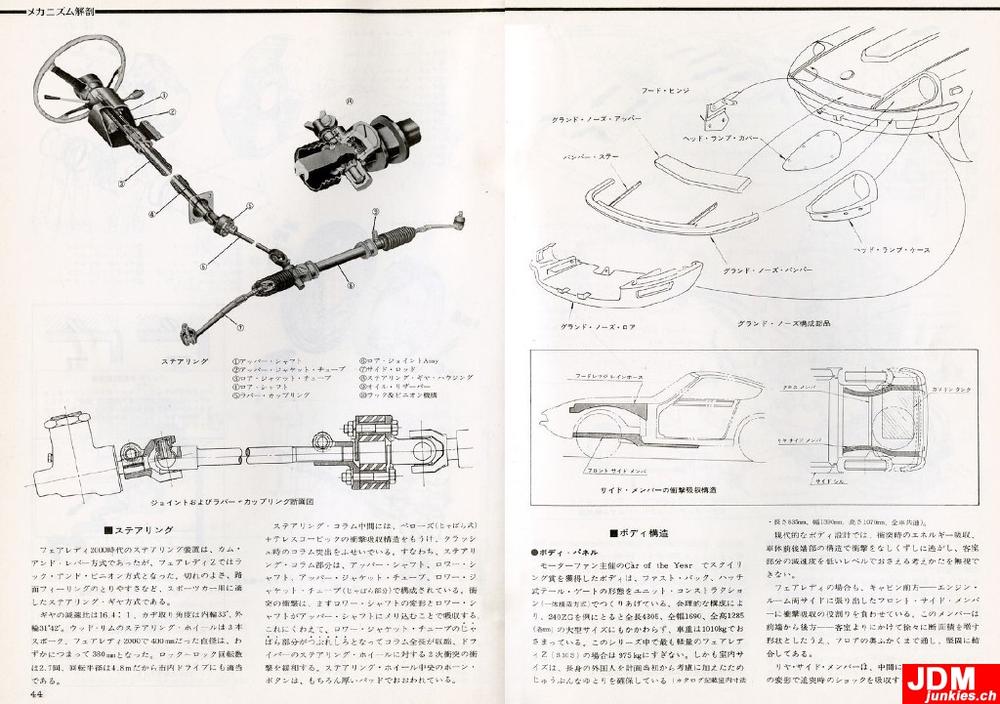

2) Japanese masterpiece series [Vol.12] - Nissan Fairlady
This book is actually a bit older (released in August 1973).
The cool thing is, it contains some backgronud information but also a lot of nice drawings and technical information about the different version. as shown below.
Still have to read it as well, but they seem to be (aside from the factory books) some of the more promising and serious books i bought. But i still have to prove my initial feelings about them ?

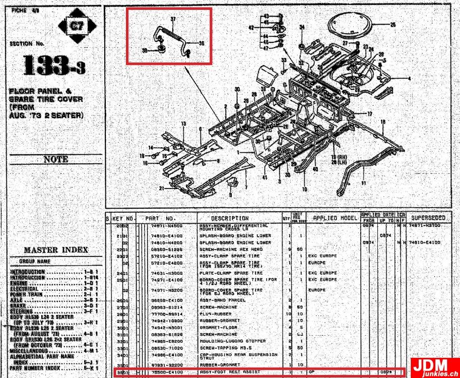

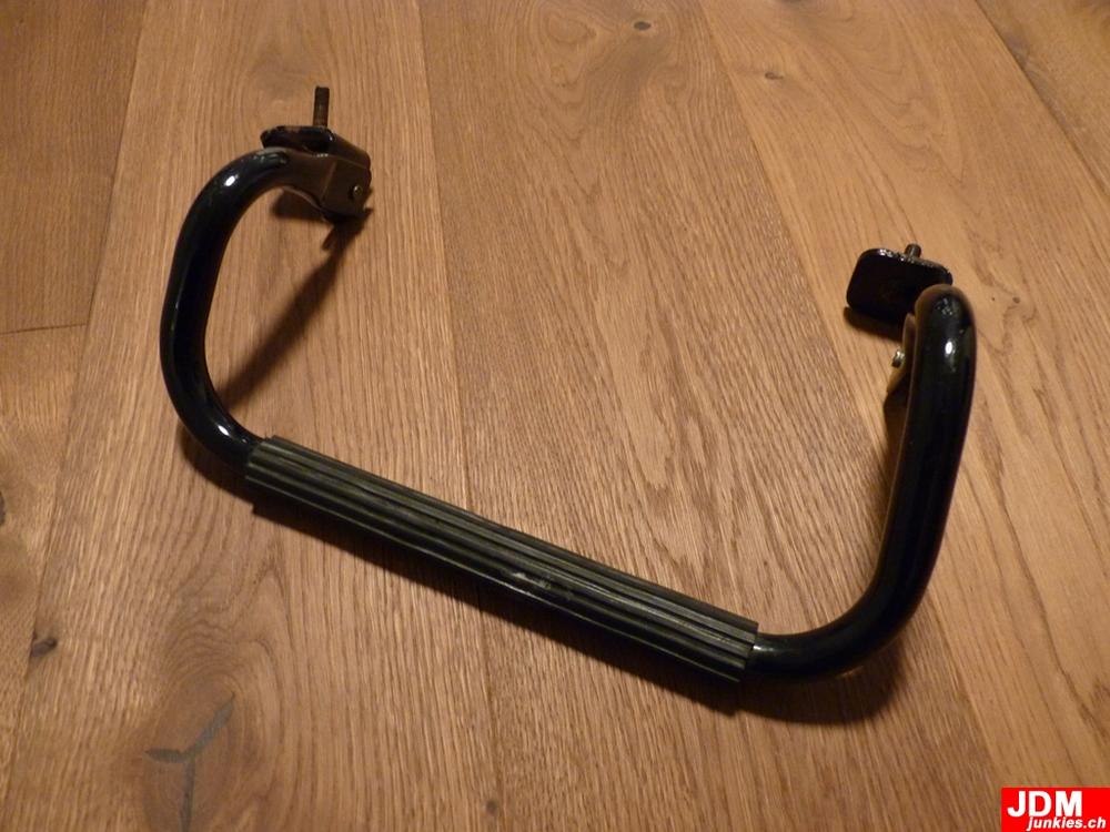

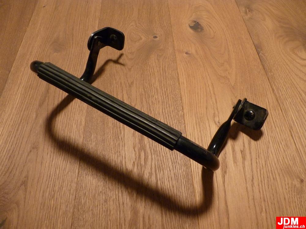

Two weeks ago i found a footrest for the 240Z for sale on a local ads-website. I remember i've seen them before but never really investigated about them. Both my cars came without them. This particular item was from a 260Z 2+2 and got a fair price-tag, so naturally it gathered my interrest.
Turns out that the parts fiches say that it's the same unit as used in the 240Z (both LHD and RHD) and was an optional item. I love optional stuff. and since it was cheap and seemed to be in easy restoreable shape, i had to get it ?
And yesterday i finally got the package with it. It's a bit rough around the edges but when in bring my next bunch uf parts for sandblasting and powerdercoating this will go in the same delivery:
I'm not really sure how "rare" this item is, but i think i've never seen it on a swiss car. And as a serious parts-hoarder i love to collect these things anyway ?

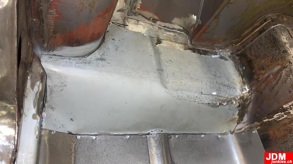

Nothing huge to show you, but i got another update from my Bodyshop guy. The area behind the passenger seat got formed out of a piece of sheetmetal and installed. ready to weld in all of that stuff, including the floorpan.
WhatsApp-Image-2020-02-03-at-16.53.34-Ko
Footrest is cool!  I have never seen one of those!
