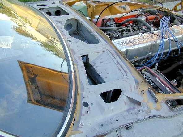

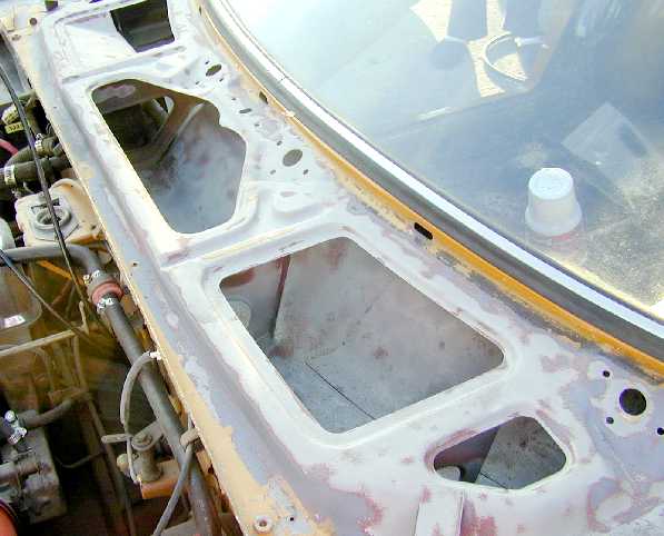

I'm posting two pictures and I'll continue my post on a third reply:
Ok, by now I hope you've looked at BOTH pictures. They are a picture of my car, BENEATH the cowl metal, both the right and left sides.
Did anyone notice that in EACH picture you can see no less than THREE wiper mount holes? That means that there are FOUR wiper holes on the car.
Four wiper holes, hmmm, do you suppose that Datsun originally considered using very short wiper blades since most Japanese people are short and therefore don't really need a tall wiper blade since they'll never look out the top half of the windshield? HA!
The answer, in my opinion, is that Datsun INTENDED this vehicle to be easily converted from RHD to LHD or vice versa. So as to whether the car was originally designed to be one or the other.... A human ovum is neither male nor female, it isn't till the sperm actually breaches the cellular wall and the two diploid genes are mixed that you have a definitive gender assignation. And even that has been shown to sometimes go awry.
So, RHD cars with the brake on the RH side vs LHD cars with the brake on the RH side can be debated all you want, but in my opinion Datsun may have intended this to ALSO be a switcheable feature. If you look at the plate for the hand brake that is below the jute and vinyl, you will note that other than being welded, they could be interchanged side for side. That would allow the brake to be mounted on either side.
