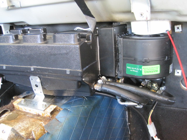

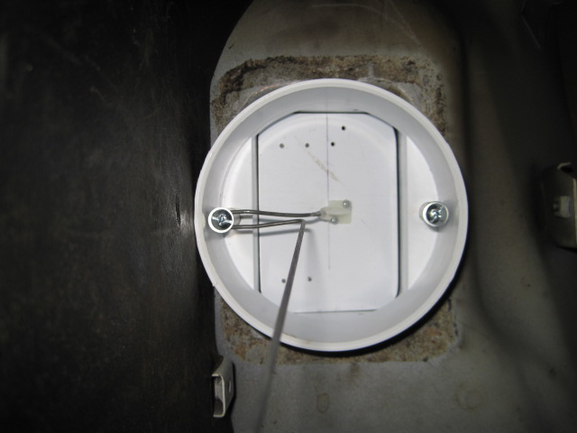

I've just completed installing the VintageAir Mini and controller you are thinking about. I did decide to modify the system to retain the fresh air ventilation. This required the creation of a damper door inside of a shuttle. When raised, the damper door is closed and air is taken from the interior into the top and bottom of the fan. When lowered, the damper door is opened and the shuttle drops onto the top end of the fan.
In order to facilitate the fresh air shuttle, I moved the fan left by inserting a duct box. I also inverted the fan to move it forward and to aid the shuttle fit up (avoiding the wires that were on top.)
