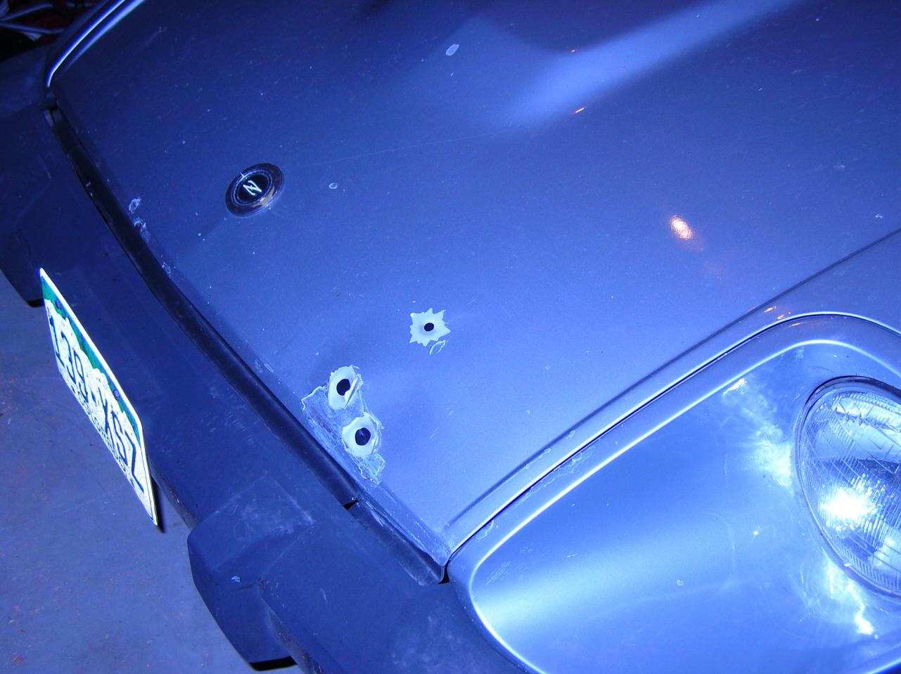

The car needs: New windshield (pitted), new paint (hood dented, rest faded), new clutch/throwout, new rear pads / rotors, new rubber around the windows / doors, installation of new front struts (squeaky old ones), new tires all around, new synchros (1st gear) in tranny or rebuilt...
