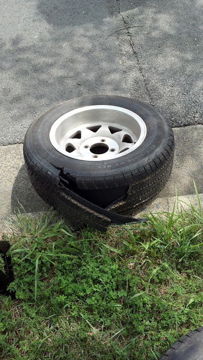

John, Thank you for the insight. I'll really need to measure the wheel, but I suspect they have a negative offset. Someday I'll figure this wheel & tire thing out.
These are the wheels. If you really squint, you might be able to see why I'm replacing the tires.
