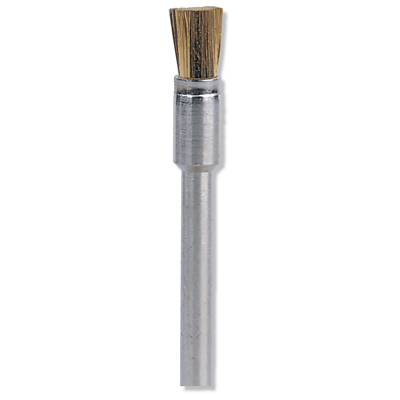

I used a regular buffing wheel on a handheld drill as already suggested. For the little "valleys" I used a tiny brass brush on a dremel after the nylon one didnt cut it. The brass brush is great for cleaning but you then have to polish the area, a soft buffing wheel will get inside the valleys enough for polishing. The polish I used also has a sealer that needs to be reapplied yearly. Its been over a year and still looks good and I think its because the part is rarely exposed to sunlight. At least with the sealer I wont have to remove a faded clear coat in the future.
