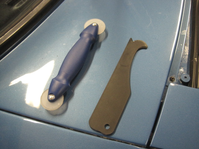

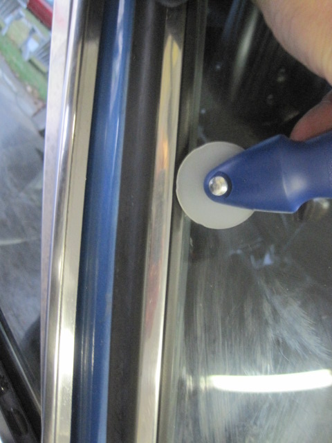

I rummaged thru my tool box for something that would work to assist me on putting pressure on the trim. As you know, this SS trim will cut you up. I came up with this tool that I purchased to install storm door screen. The beauty of this tool is that the one side wheel is actually grooved to help push in the rubber seal that holds the screen in place. Well that groove also does a wonderful job of putting ample pressure on the SS trim-without slipping off. That groove rides right over the edge of the SS and rolls:cool: Thsi makes it nice to roll along the SS while pulling the seal over the trim. I kept the roller in front of the direction I was working -keeping the SS shoved down into one side of the seal, while I was pulling the other side of the seal over the SS.
IMPORTANT; keep everything wet with some soapy water-all the time. I prewetted the grooves of the seal before ever starting, but the water will dry up, so you need to keep wetting things as you go.

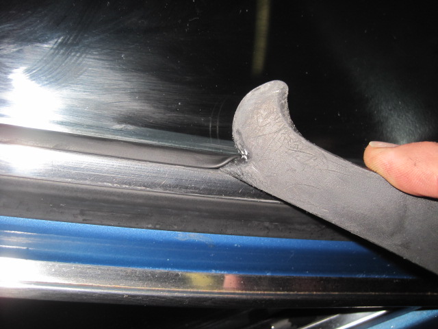

As far as the other tool in the picture, I can't remember where I got it or what I have previously used it for. I've had it forever and used it before when I needed something plastic without a sharp edge. As you see it has a kind of forked end; I used the the small pointy part to get under and grab the seal. So as the roller tool was keeping pressure on the SS, I followed with this tool riding against the SS and prying the seal from out behind the SS and over the edge of the SS. This is where the wetter the better happens.

Well I was able to get the picture manager to cooperate. The pictures aren't real telling, but they do show my weapons of the windshield battle. Like I said earlier, the double roller tool there has one roller that is actually grooved in the middle. Great for holding on that sharp trim. The other tool I seem to remember buying this as a caulking removal tool at Lowes or something. Tough little plastic tool that does a great job of lifting the seal.
So maybe you can kind of picture the roller applying pressure to keep the trim from springing out of the seal lip ,while the second tool follows pulling the other edge of the seal over the trim. You can see that the seal lip rides nicely in the fork of that tool. Though the tool looks like it maybe to sharp, it doesn't cut the seal, only the SS will do that.

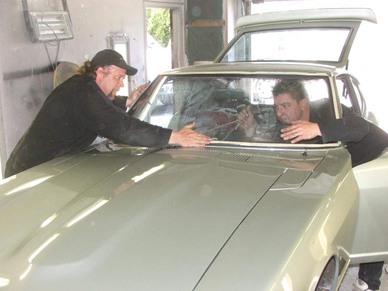

Was that JUST for the Stainless Trim, or did it include the front and rear windshield panes installed for that amount?
E
Both windows and trim.
They slid the SS trim in before installing the glass.
they were down the road in about an hour and a half.
It would normally be about $250 but they do a lot of work for my brother in his body shop and cash talks:)
