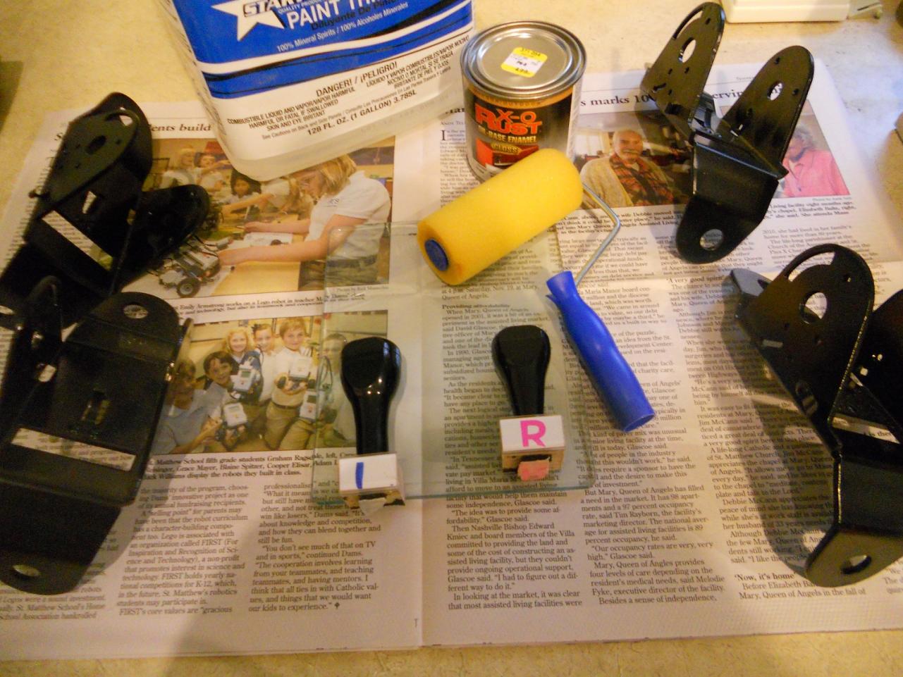

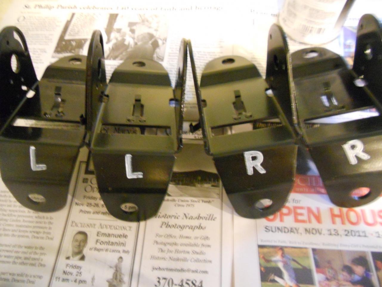

OK, I have two sets apart at this time. I have had the cradles blasted and powder coated (gloss black).;) They look great! (photos in a day or two) I am having rubber stamps made to match the R & L stamped on the black cradles (can you say anal-retentive). I started getting the zinc plated parts ready for plating, wire brushing corrosion and old plating off.

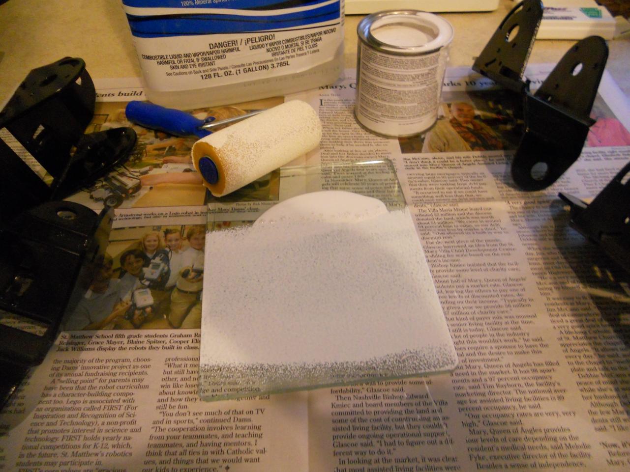

OK, The cradles are back from media blast and powder coat and ready for the little detail of stamping R (right) & L (left) on them. The part number stamped in the metal contains an L and R on the reverse side but is covered when the boot is installed. I am guessing that the white stamp was an afterthought for production purposes. The white stamped R & L cannot be seen once installed but for restoration purposes I wanted to re-produce this detail. I first tried to cut my own stamp but was not happy with the results:ermm: so for less than twenty bucks I had a set of stamps made at a local shop. I purposefully used a slow drying white enamel to give me time to work with the stamp. I evenly rolled out the paint on a plate of glass and stamped the glass then the cradle. Overall I am happy with the results they look very close to the original stamping.;) Now waiting for the zinc plating of the re-tractor parts.

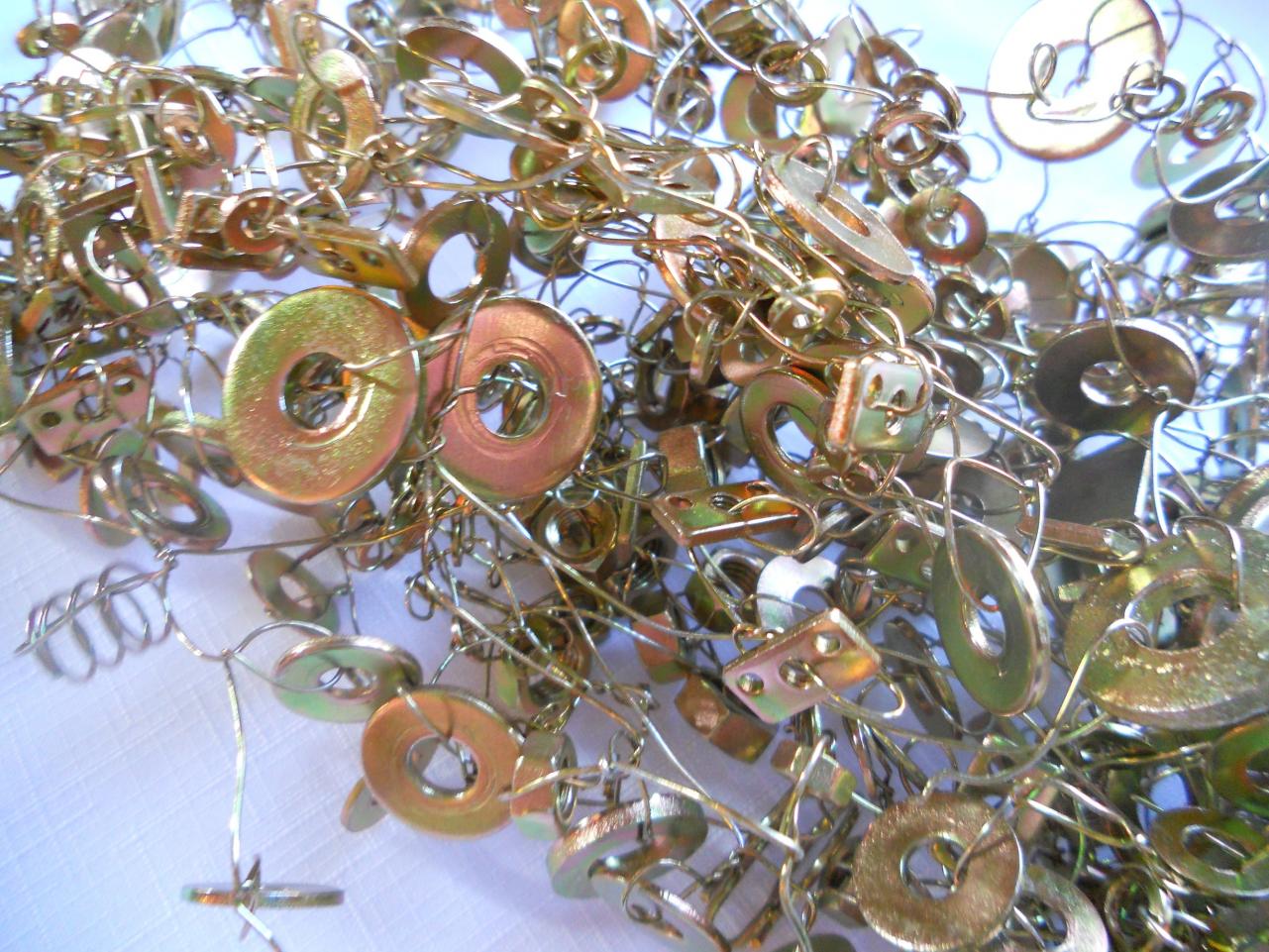

Took a drive to Muncie, IN today to drop off parts for zinc plating. It took a while to get thins ready to go due to the fact that the plating company had a minimum charge so I prepped hundreds of nuts and bolts etc... wire brush all parts then wired all small parts together with small gauge wire all very time consuming. They are now there and the company has promised a 5 day turn around. Did a little driving in Muncie to check out some places I remember from my days in college there. This is also where we lived when I purchase the Z.

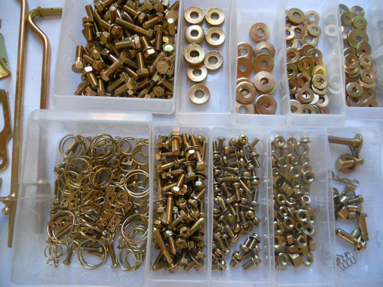

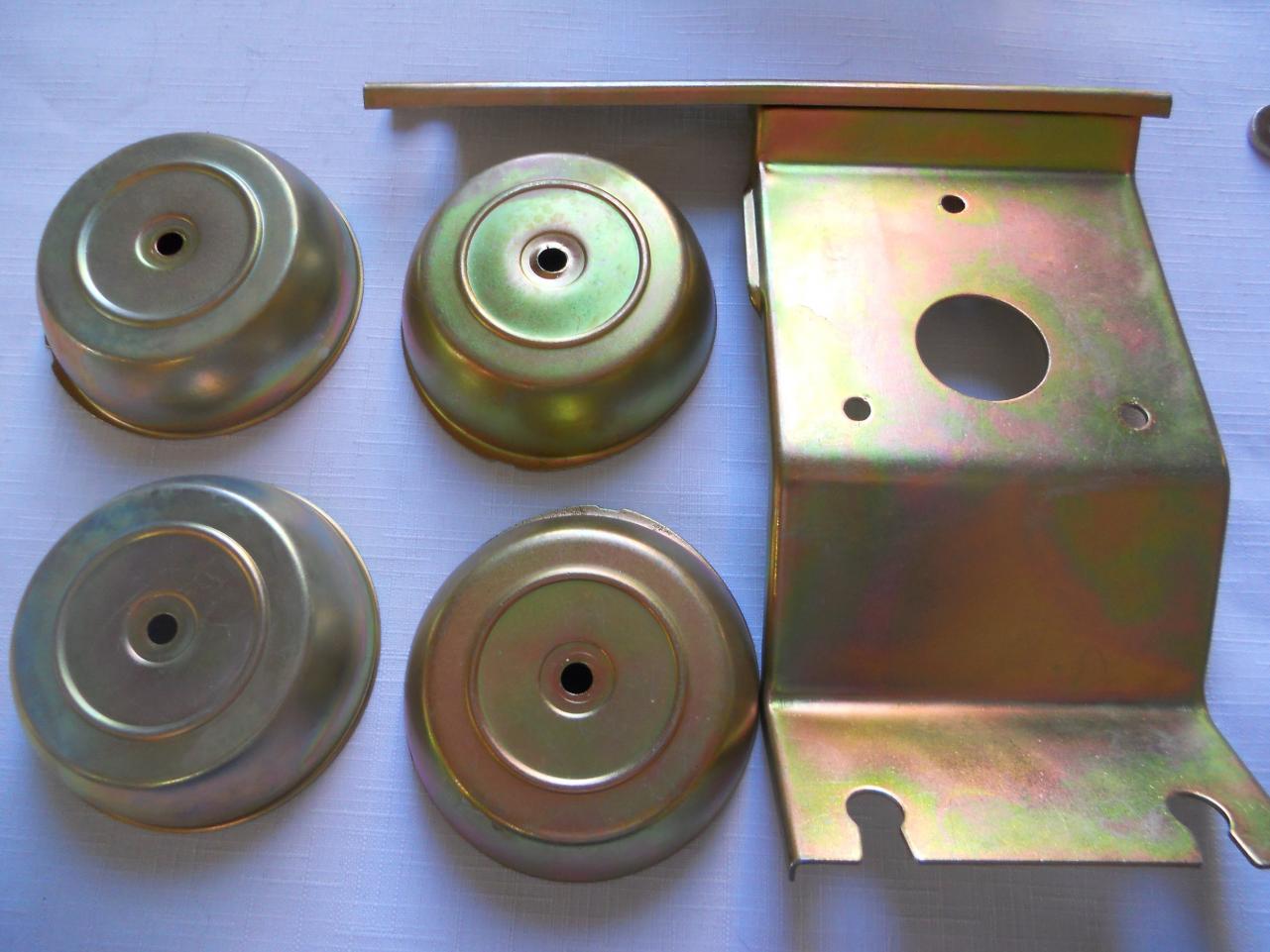

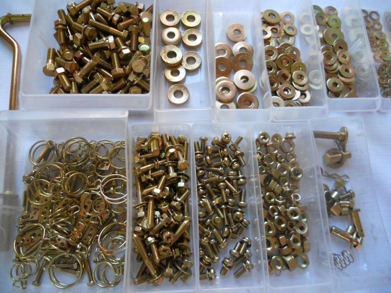

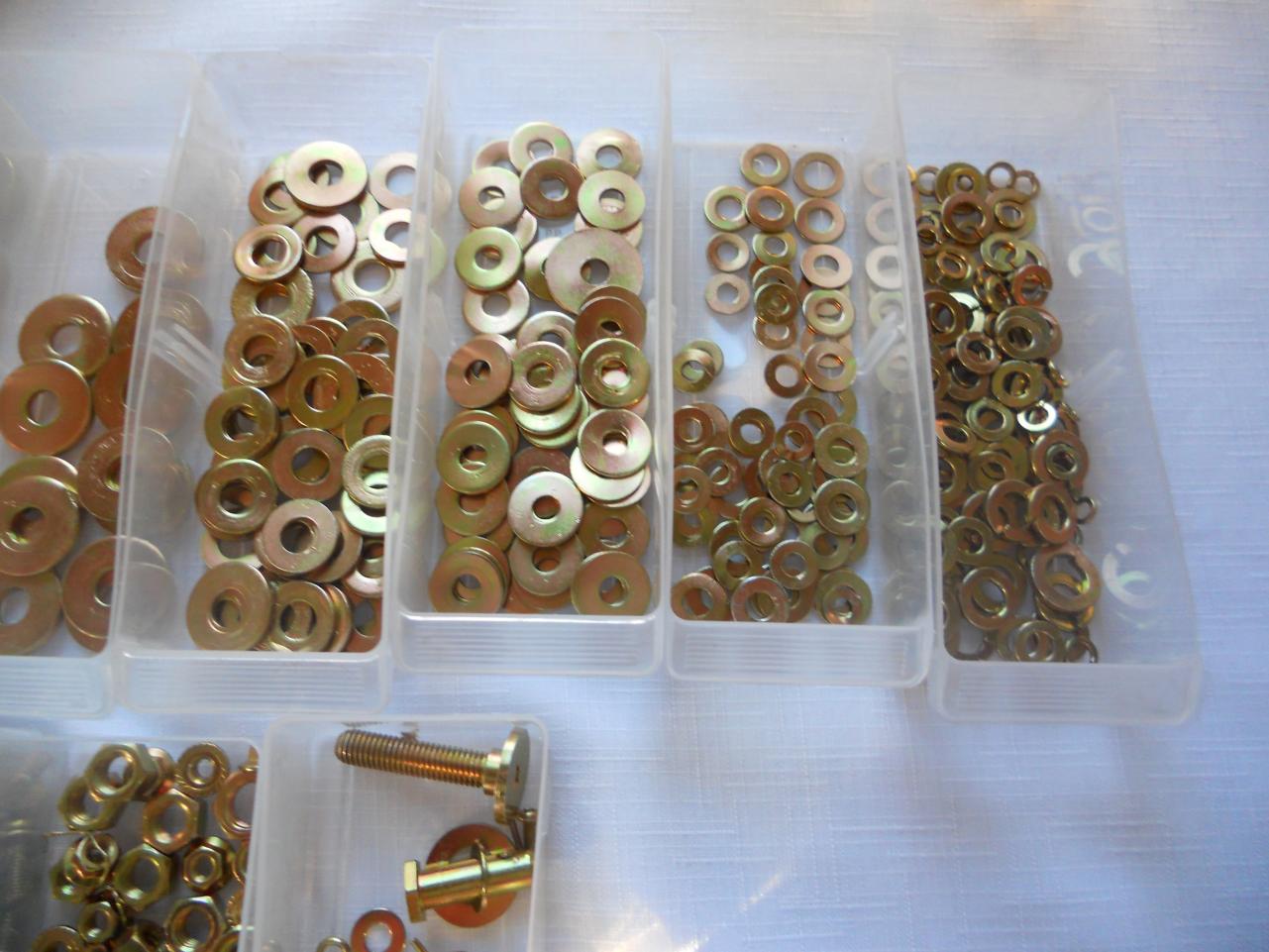

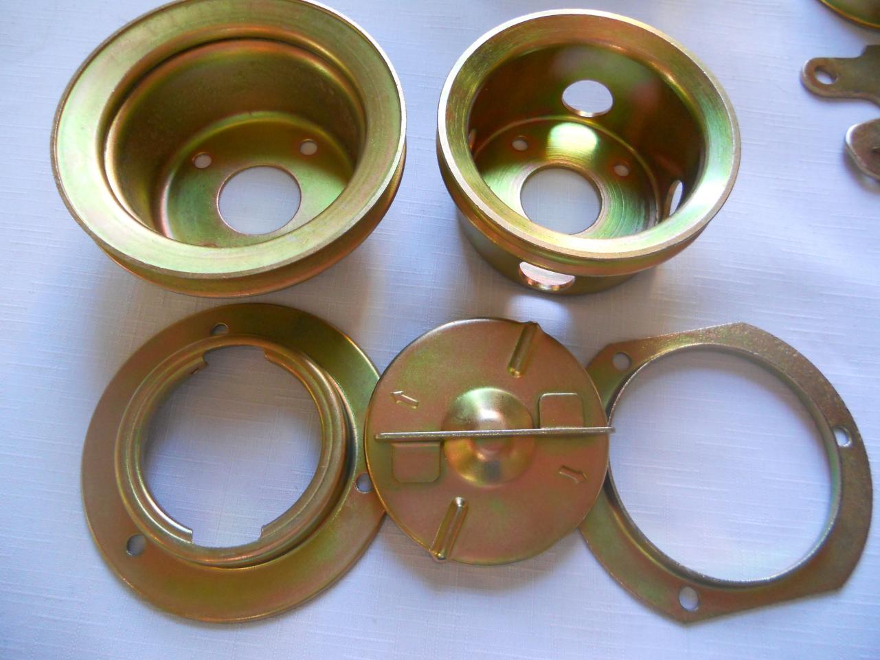

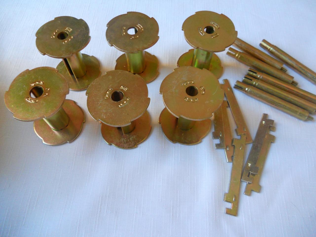

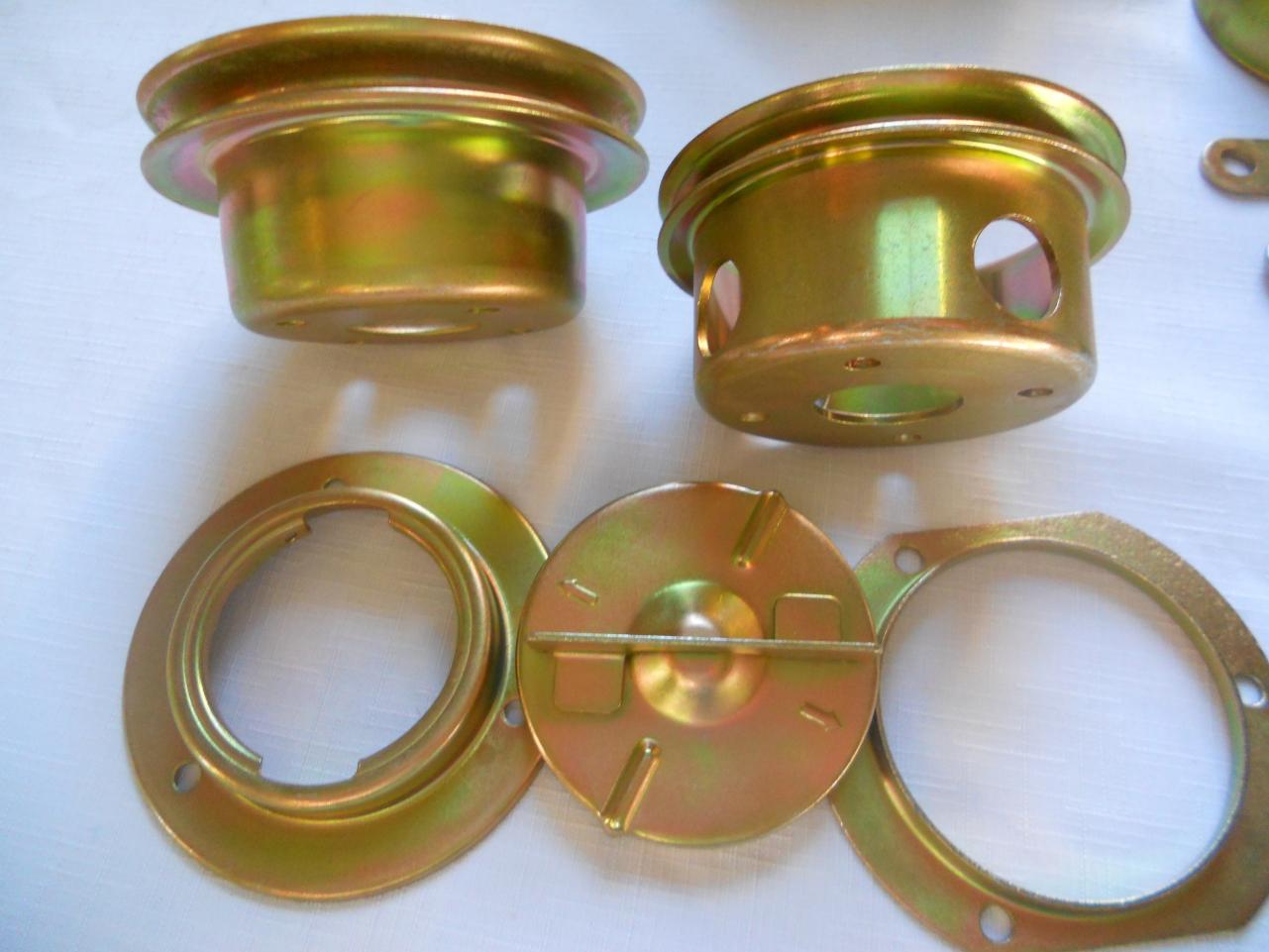

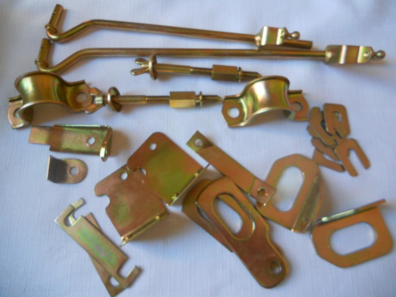

Picked up my parts today from the plater, I did not get my clear or black zinc parts ready in time to drop them off so I will have to make another trip to Muncie in the near future.:ermm: I am very happy with the work.:) The company is a large production company and only does “car guys” parts as a favor. Good People! I have attached photos of the seat belt parts, where this plating project began,:rolleyes: but I have also attached photos of the parts in total. I took some pictures of the small parts which I daisy chained together prior to taking them loose. They came back in a tangled ball but the process worked out well. I had been told that the outcome of the process would be equal to the prep-work. This process was labor intense but well worth the outcome. I believe that I will start a thread dealing with plating beginning with the prep-work in the near future if members are interested.:paranoid: I know that it has been a learning experience for me. The two pulleys are part of a set of an early Datsun Comp ¼” belt drive system.
