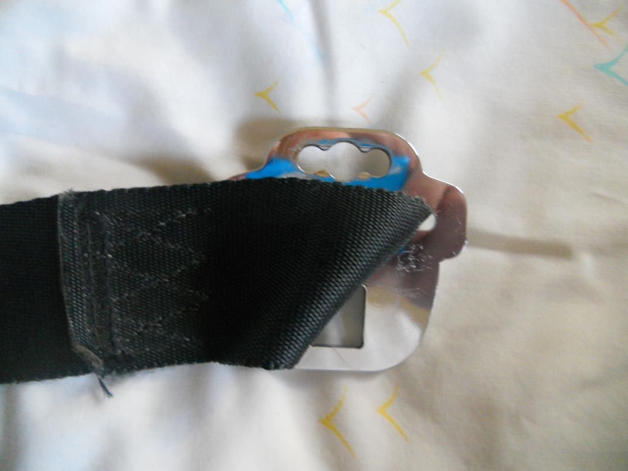

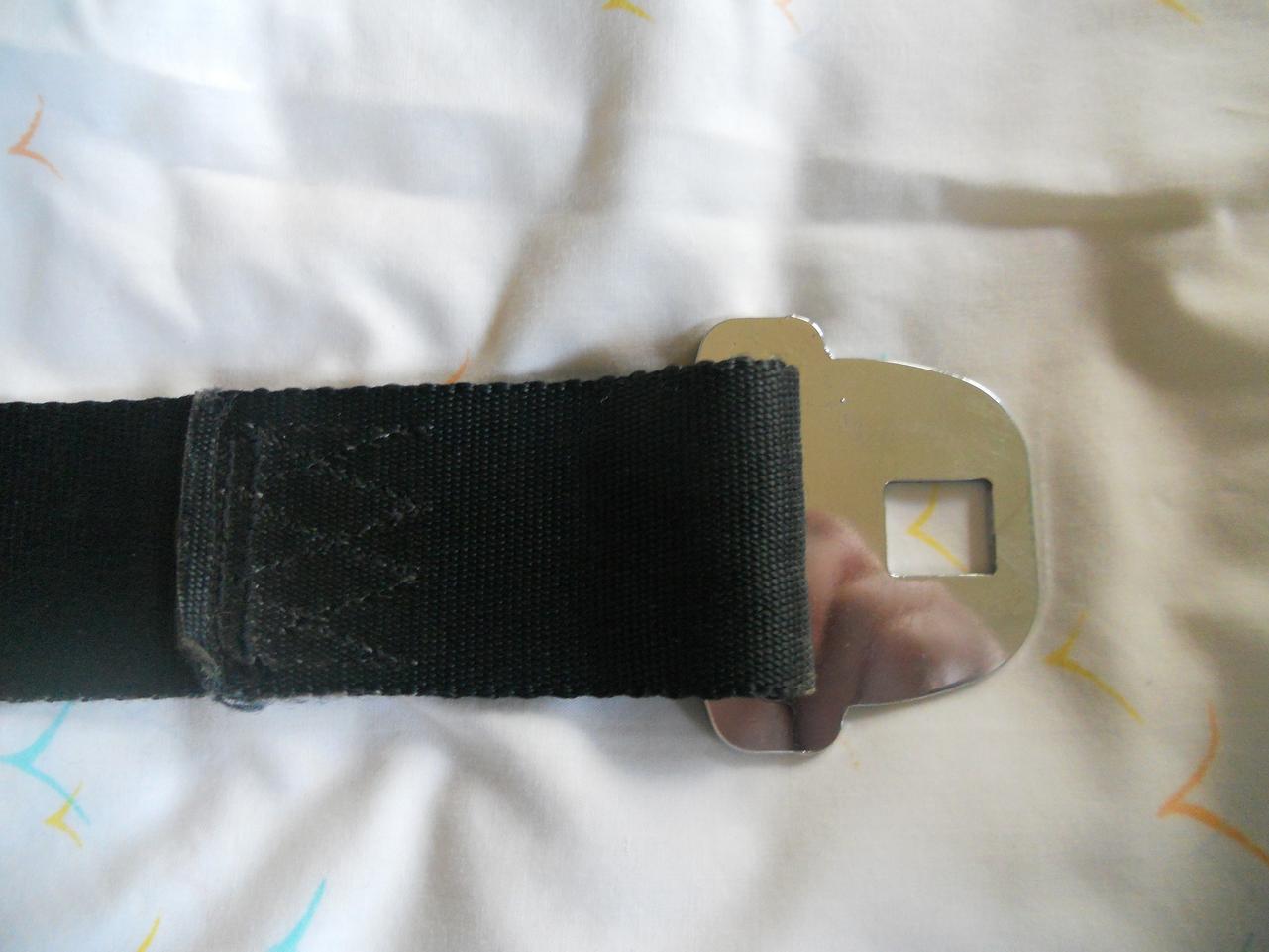

i just checked my 72 belts ( no retractors) . if you flip the male connector over then u can see the slot for the shoulder belt. it's on the inside of the male part.
On the retractable belts the keyhole for the shoulder harness is within the loop where the webbing attaches to the male end of the lap belt. Thus this was missed by Ssnake Oyl. They, rather than re-chrome my ends installed new incorrect ends. I have attached photos of one of my original belts which were returned with my restored belts by Ssnake Oyl.
