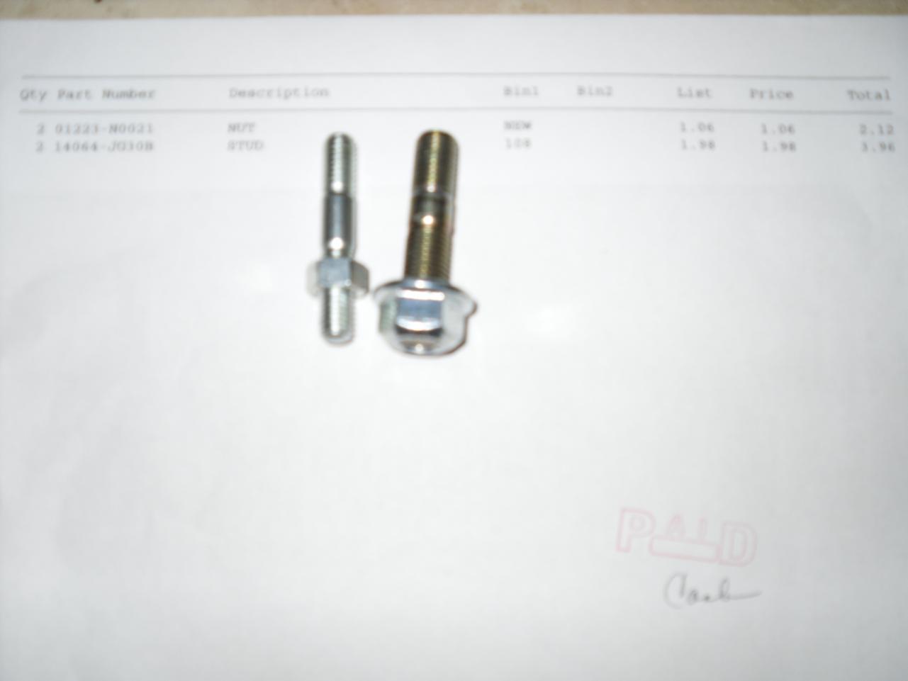

I tapped my head into M12 on #1 & , they were M10 and threads worn over time. I found everything at Nissan dealer and could get you the part #'s if you want. Seems like they were for the truck motor but worked good and could tork them down really good without loctite or orther thread lockers, the heat is too high.
Cylinder head bolts are M10, intake/exhaust manifold threads are M8.
I was talking about the exhaust studs on #1 and #6. They were M8's originally, I confused them with the 4 intake M10's in the center, sorry. I found my recepit and I am wrong once again, they're M10x1.25 studs with M12 deformed nuts.
It's more likely to be M10 studs with M10 deformed nuts. Otherwise, they wouldn't clamp much of anything!
