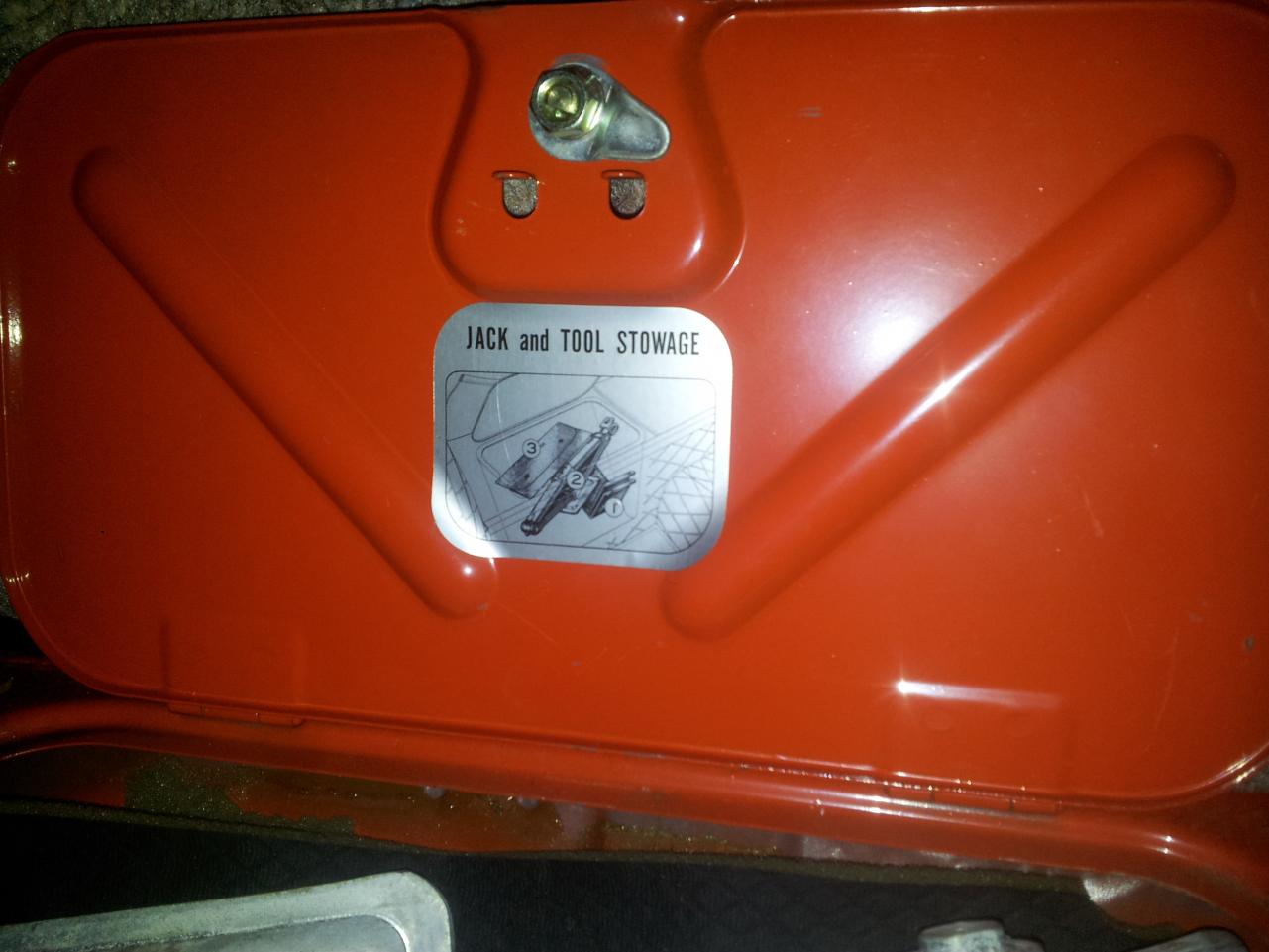

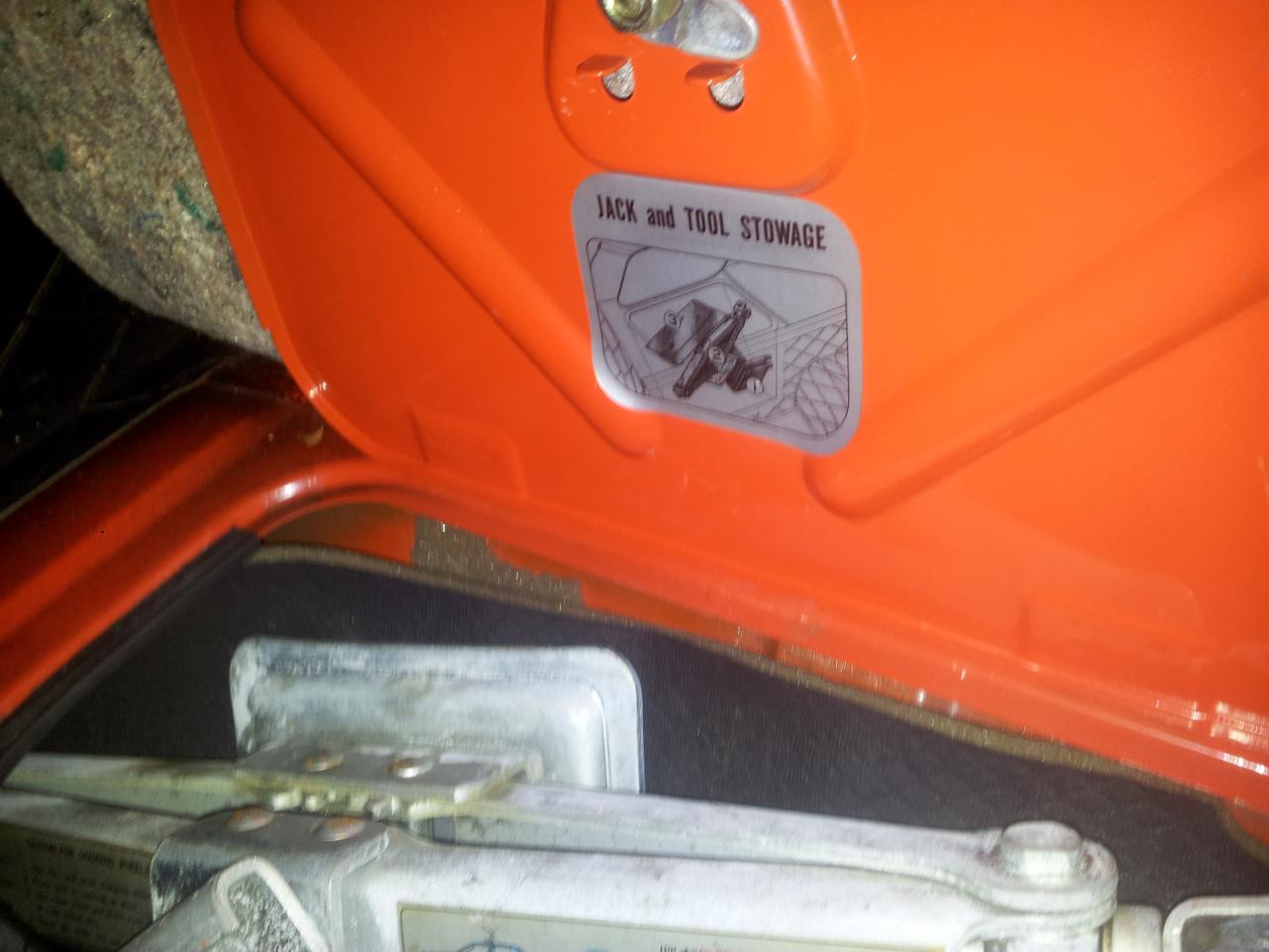

OK, I have ordered some reproduction labels for my car and it seems that there are different opinions on the correct label content, background, etc.. :ermm:Norm Murphy after looking at photos of my car said that my under hood stickers were incorrect. I purchased a set from him along with one for inside of my right tool box lid. All three stickers are on either gold chrome or silver chrome:disappoin. I do not remember them being on this type of material. I seem to remember them being on a flat gold and flat silver background. The chrome look makes them hard to read. Which is correct? Content wise the sticker for my tool box from Norm like I said is chrome with black print and has three steps illustrated on tool placement but when I took a look at an extra tool door I have the label is on a flat silver background and has one drawing of the box with the tools properly located in it. This door is off a 4/72 production car my car is 7/72. What is correct???:ermm:

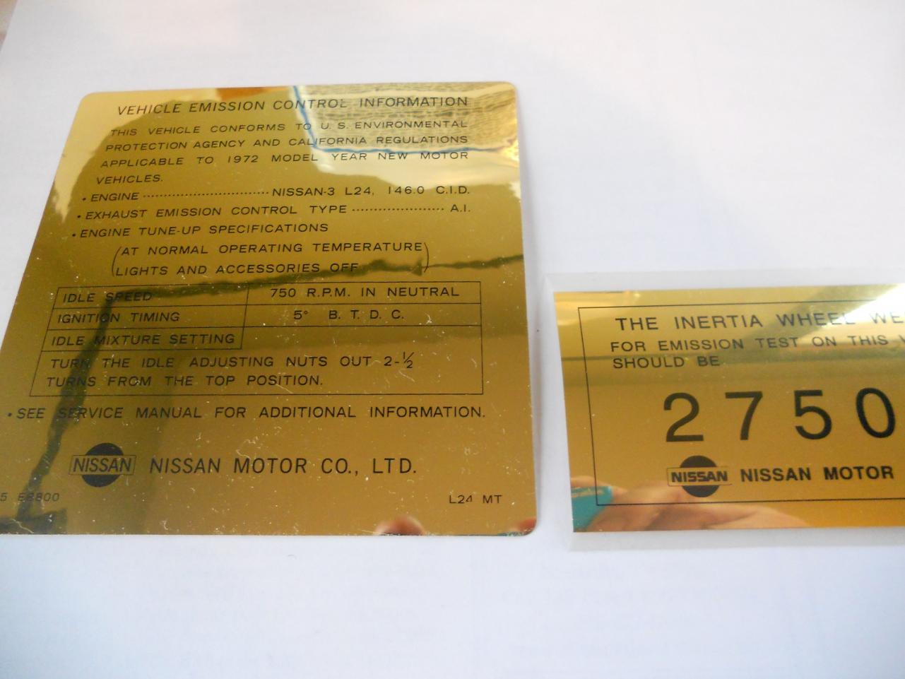

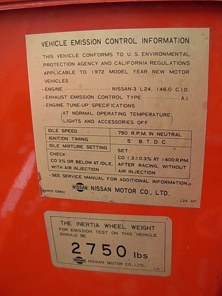

The original under hood decals on my 5/72 are a gold foil. Here is a picture.
-Mike

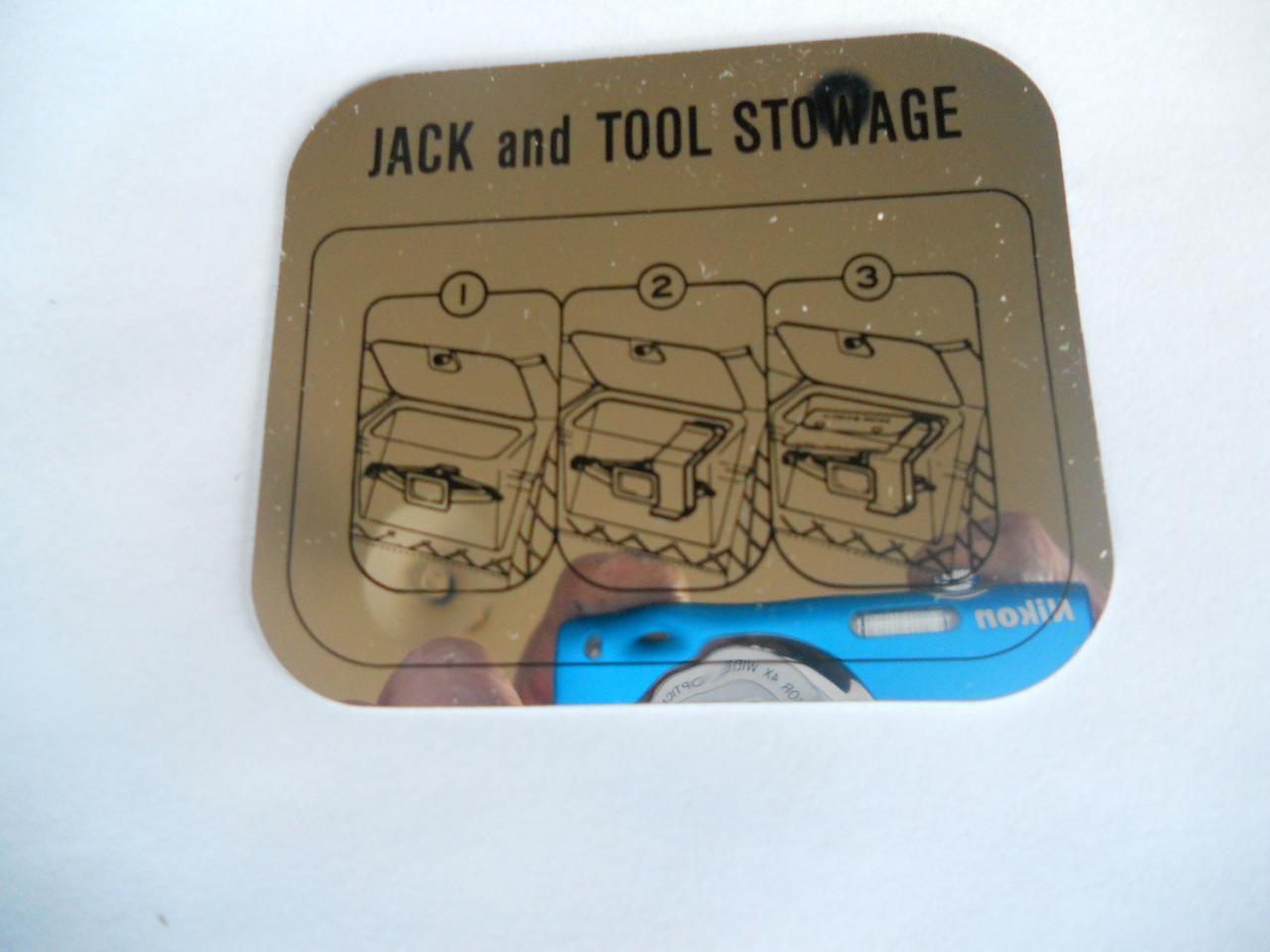

Mike, I know that they were on a gold background but my question: is the gold a flat gold or a reflective gold chrome? You photo seems to show a flat gold background such as currently reproduced and sold by Banzai Motorworks. I recently bought a set from another well known vendor and when I received them they were on a gold foil (reflective chrome look). When I questioned the vendor he said that for the 72 this is correct and that he was able to get the last of this material from the original manufacturer in Japan. I just don't remember that material. I do remember the color code and the tire cover alignment arrows being on a reflective silver chrome look material. I will try and post a picture today but it is hard to photograph the reflective material.

I have attached some photos. The material makes it hard to get good shots but I believe you can get an idea from these.
Jerry, the photo I posted is what the original decals on a 5/72 car look like. I guess you can decide how '"flat gold or reflective gold chrome" they look to you. None of the reproduction under hood decals I have seen, either gold or silver, (including those from Banzai) look exactly like the originals. I'm not sure if the original materials are no longer available or if people just haven't found the right source to make good reproductions.
-Mike
