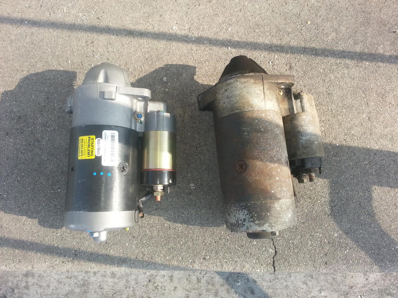

Definitely not corrosion. The starter went from working acceptably to its current state between cranks, mostly my fault and the weathers.
Bitter cold day, but I got the new starter in. Turned the key and got one turn over, and now just a rapid clicking noise. Probably killed my battery, too. Its back on the chager, we'll see how its doing before long.
Battery is fully charged, and she turns over with a vigor I've never heard since I got her. Here's a side by side.
As you can see, my old starter looks as if it was stored in a swamp.
