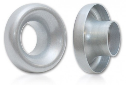

A properly shaped SU entry (bell mouth) to improve performance... not a less-performing air horn:

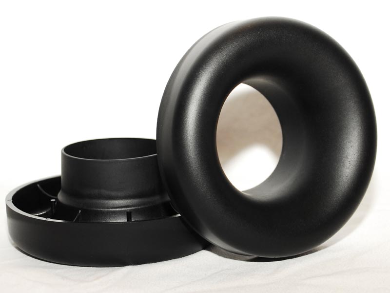

Here is all you can buy in North America:
A Toss Ring DIY!!!

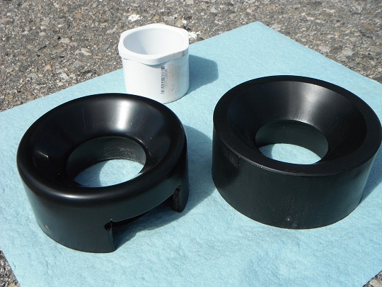

Datsun SU stacks could be made from aluminum or a resin:
And of course, the results of testing

The aluminum bell mouth photo is from a british site and for a british (non-hitachi) SU. The plastic USA drag racing substitute is made famous by a Z racer named "Norm The 12sec SU Dude"
With respect to the stock SU air horns, I think they are more like #3 in the table of shapes.
Here is the data from Norm's Testing:
"The airbox carb stacks are actually restrictive due to their not being fully radiused. I actually cut them out of my old airbox and tried them under the K&N filters but the car ran about .05 seconds slower than using nothing at all. When I installed these custom stub stacks I actually picked up about .05 seconds in the 1/8 mile."
These are usefull for high rpm & high hp applications.
