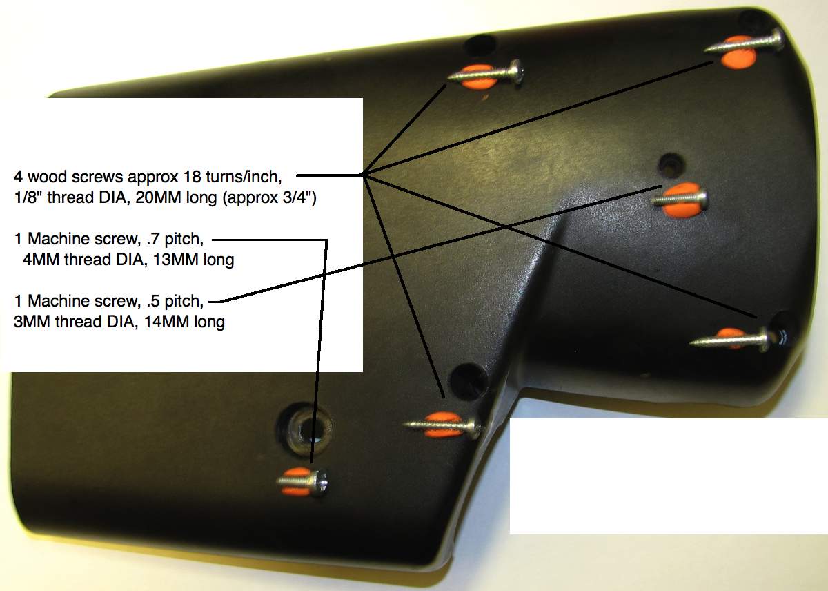

Anyone have a picture of the four screws in question so I at least know what I'm hunting for? Are the threads more like a machine screw, or a wood screw?

I am willing to take a picture of the screws that came out of mine (they have wood screw threads -edit they look like self tapping) since I have the clamshell apart but although they work I don't know that they are the ones that are supposed to be there. They are taped to the clamshell right next to each hole they came out of outside in the 17 degrees that we have here now as I have the clamshell apart. Plastic usually uses wood screw threads right? My screws are trying to strip out too and I went to a lot of trouble with glue and a heat gun (to correct warping maybe from heat?) to salvage the clamshell I have. A coupe of posts the screws screw into were broken off.

They are self-cutting, or -tapping, and cut their own threads in the plastic when first used, I believe. Very coarse thread. Similar in pitch to the self-tapping screw shown in this link - http://www.bbc.co.uk/schools/gcsebitesize/design/resistantmaterials/jointsrev2.shtml

Mike, If you get a chance to take a pic, I'd be much obliged. I'm not in any hurry so don't risk frostbite for the pics, but when you get a chance. Haha! I really don't want to have to hog those things out with a bench grinder!

I have used #6 x 1 inch wood screws as replacements. They are virtually the same diameter as the stock screws and will not blow out the fragile posts when inserted. Some light oil on them will help as well. Tighten them very evenly and slowly and no more than necessary.
FWIW here are the screws used now on my clamshell that work. The 4 screws that are all the same size may well be a #6 size I don't know. Sorry for the blurry photo Captain Obvious, if you want close up pictures of the 6 screws let me know.

Thanks much Mike. Now I've got some kind of idea what it is that I'm looking for.

Thanks I was hoping the picture would help.
