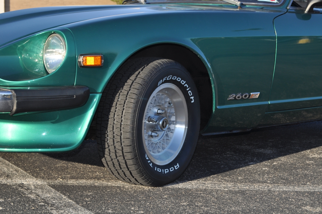

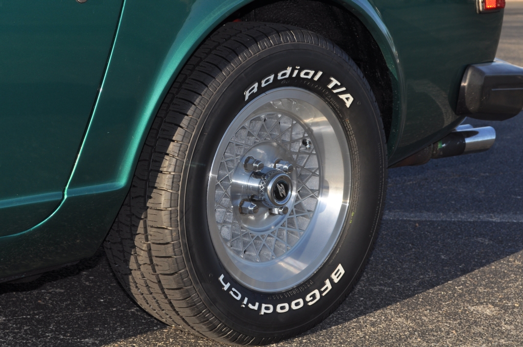

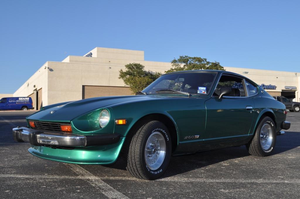

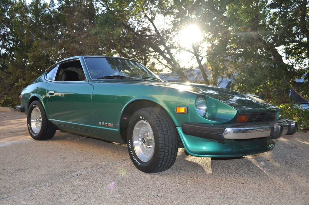

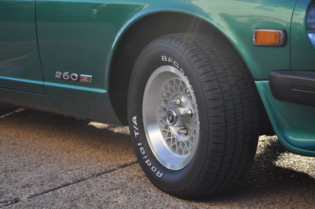

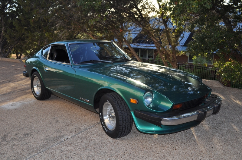

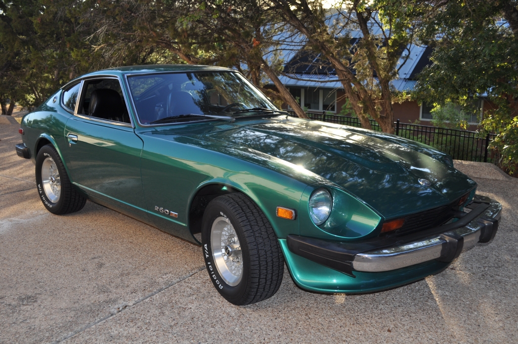

January 13, 201312 yr comment_411774 I have the exact same type and size wheels, although they are on a late model 260Z (11/74 manufacture date). It has an aftermarket air dam and does not have the original valance that came with the car. In the pictures below I was running lowering springs along with KYB strut inserts. I run BFG Radial TA 225-60 R14 with no issues. Never had a rubbing or interference problem, front or rear. Here's a few pictures for you so you can get an idea of how they look. Mike. Link to comment https://www.classiczcars.com/forums/topic/45394-thoughts-on-20570r14-on-appliance-14x6-lowered-240/#findComment-411774 Share on other sites More sharing options...

January 13, 201312 yr comment_411798 The above two owners with no problems have different situations than the original poster. Big bumper cars (late-260Z and 280Z) that have not been lowered sit higher than a stock 240Z, and aftermarket airdams have much more clearance at the tight spot than stock valances. I STRONGLY recommend checking your clearance closely prior to buying different size tires. For this reason, I do not recommend buying your first set of a new size mail order, but from a local dealer where you can test fit them. Link to comment https://www.classiczcars.com/forums/topic/45394-thoughts-on-20570r14-on-appliance-14x6-lowered-240/#findComment-411798 Share on other sites More sharing options...
