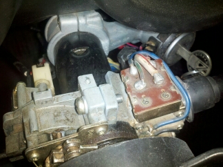

boosd Posted January 14, 2013 Share #1 Posted January 14, 2013 So a few months ago I took my car in because my parking lights failed after the wiring at the combo switch melted. I took it in, and had the switch and wiring replaced... Everything seemed fine, I took it out for the first time today and tonight when I got in it to drive home I realized my headlights and my dash lights arent working. I pulled took off the covering around the steering column/combo switch and began to look around and found a few disconnected wires. Got the Headlights working which is a start, but dash lights still arent working, I think something is incorrectly soldered/wired because when i went to adjust the dimmer knob, my parking lights are going dim or bright when turned... maybe something is just plugged in wrong, or not plugged in? I also found a connector that is unplugged and i am unable to reach far enough up to plug the two in. Here are a couple pictures 1974 260z Link to comment https://www.classiczcars.com/topic/45408-stuck-in-the-dark-electrical/ Share on other sites More sharing options...

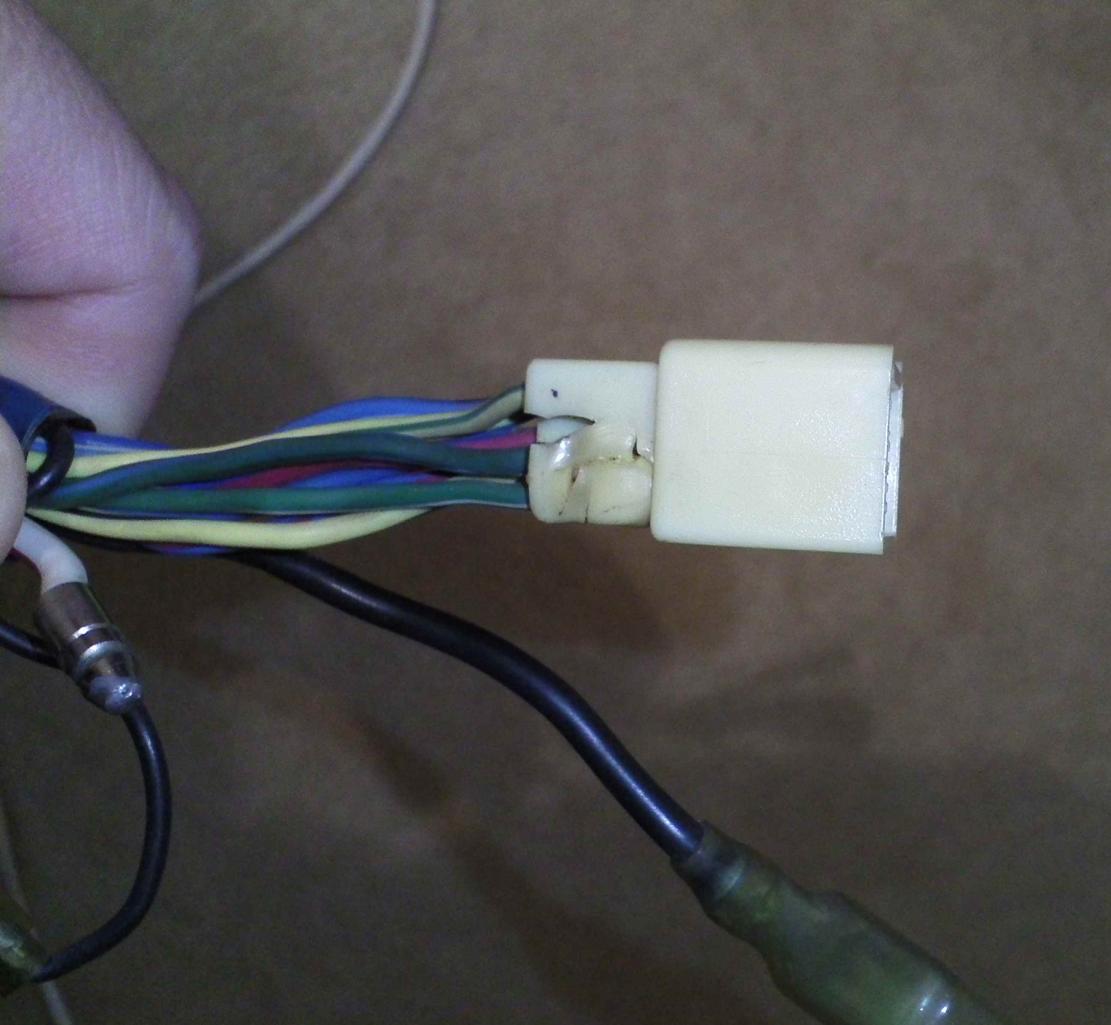

SteveJ Posted January 14, 2013 Share #2 Posted January 14, 2013 The 74 headlight switch has one nine-pin connector (parking lights and wiper). It also has single connectors for a black wire (ground), white/red wire (power coming in for the headlights and parking lights/dash lights), and red wire (headlight power to the fuses). There is also a black wire (ground) with a connector that allows two wires to be plugged into it independently. If you really think your headlight switch is hosed, you can actually still buy a new one. Rockauto has them for $157. I have one in my 260Z. Compare it to yours: More Information for STANDARD MOTOR PRODUCTS HLS1026.First verify that you have a good, functional switch. Inspect the nine-pin connector closely. That's the one for the parking lights, and I have seen signs of overheating there.What are the wire colors going into the unplugged connector?Be sure to download the 74 FSM from the link below. The BE section does a very good job of breaking down the circuits for you to troubleshoot. In particular focus on pages BE-10 (headlights), BE-14 (parking lights), and BE-16 (dash lights). After comparing what the manual says to what you see, post your findings and questions, and we can probably give you a path from there. Link to comment https://www.classiczcars.com/topic/45408-stuck-in-the-dark-electrical/#findComment-411866 Share on other sites More sharing options...

boosd Posted January 14, 2013 Author Share #4 Posted January 14, 2013 (edited) The 74 headlight switch has one nine-pin connector (parking lights and wiper). It also has single connectors for a black wire (ground), white/red wire (power coming in for the headlights and parking lights/dash lights), and red wire (headlight power to the fuses). There is also a black wire (ground) with a connector that allows two wires to be plugged into it independently. If you really think your headlight switch is hosed, you can actually still buy a new one. Rockauto has them for $157. I have one in my 260Z. Compare it to yours: More Information for STANDARD MOTOR PRODUCTS HLS1026.First verify that you have a good, functional switch. Inspect the nine-pin connector closely. That's the one for the parking lights, and I have seen signs of overheating there.What are the wire colors going into the unplugged connector?Be sure to download the 74 FSM from the link below. The BE section does a very good job of breaking down the circuits for you to troubleshoot. In particular focus on pages BE-10 (headlights), BE-14 (parking lights), and BE-16 (dash lights). After comparing what the manual says to what you see, post your findings and questions, and we can probably give you a path from there.So i looked at the 9 pin connector, and the wires going in (from the headlight switch) are different colors than on the other side of the connector plug, were the headlight switches across models different and this could be causing the problem?(see below)The unplugged connector is a 3 pin connector, but one of the 3 wires has been cut, so what remains is a red wire and black wire, (photo 3)9 PIN CONNECTOR (FROM REPLACED COMBO SWITCH)Gw Bg BwBw By BBy B Br9 PIN CONNECTOR (Original to wiring harness)Yg Bg GwBw Rb WgBy B BrUppercase = Main ColorLowercase = Stripe(if there is one)G/g = GreenB/b = BlueR/r = RedW/w = WhiteY/y = Yellow(The Color diagram is meant to show the colors that are connecting i.e. first: Gw is connected to Yg) Edited January 14, 2013 by boosd Link to comment https://www.classiczcars.com/topic/45408-stuck-in-the-dark-electrical/#findComment-411921 Share on other sites More sharing options...

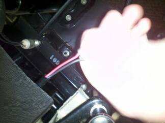

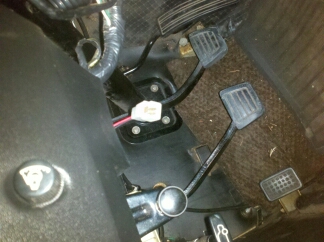

boosd Posted January 14, 2013 Author Share #5 Posted January 14, 2013 So im thinking, based on looking at the FSM that the 3 pin connector that is unplugged might be the warning buzzer from the door being ajar. I am not the best at understanding the FSM so I dont know that i will give the most accurate answers based on that, but it appears that all my plugs and wires are correct, so I think either its something to do with a mis-mmatched combo switch, which I dont know if there are compatibility issues across models, i think the one in there now is from a 240z...So the problem is that my dimmer knob is turning up and down my parking lights, and I have no illumination in my dash lights is this a simple plug? From the FSM, i dont see anything that is out out place Link to comment https://www.classiczcars.com/topic/45408-stuck-in-the-dark-electrical/#findComment-411928 Share on other sites More sharing options...

boosd Posted April 29, 2013 Author Share #9 Posted April 29, 2013 Ok, so months later.......... I order a new dimmer switch, replaced it and yep... still the same problem Things that i have learned though are... With the dimmer switch unplugged, the parking lights operate as expected no problems, when i plug in the switch everything functions correctly for about 2 seconds, then the dash lights dim, the Green/Blue wire begins to get hot, the parking light fuse gets hot, and just recently the green/blue wire got so hot it broke the solder... Does this help any? Im not a real technical person when it comes to electrical... and would love to have someone fix this for me, however the shops that i took my Z too basically told me they werent too sure about how to tackle this, which i didnt see as a great sign... Link to comment https://www.classiczcars.com/topic/45408-stuck-in-the-dark-electrical/#findComment-421964 Share on other sites More sharing options...
