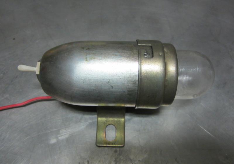

Picked up this little guy off Ebay. It was listed as restored and I would agree with that about 95% The metal and finish looks great but the switch is original as well as the lens. They are are in good shape but not great and not "restored" However for $29 shipped I could not pass it up. With these now being NLA from Nissan I think we may see more of them pop up like this. Thoughts?

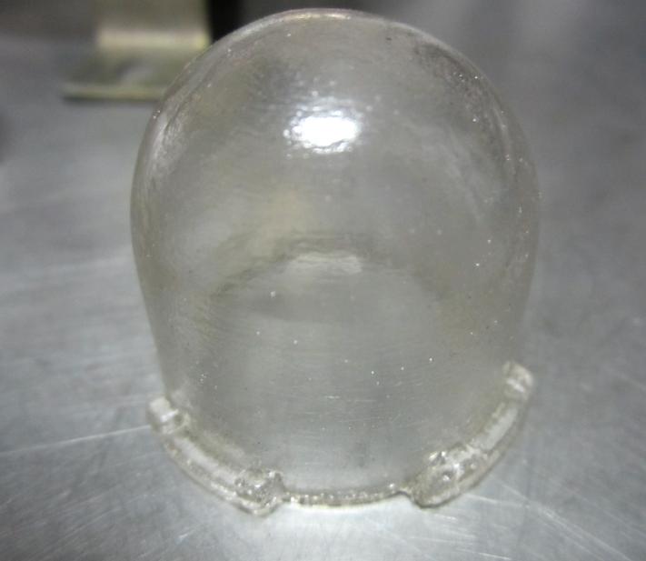

I managed to buy one from my local Nissan dealer in December. He had a lot of trouble finding it. I moulded a lens for my old inspection light to see how it would look. Its clear and doesnt have the milky original look, but its also a good alternative if the rest of the light is servicable.
Here are some photos of the lens I moulded out of PU resin. I was a little impatient and removed it before it fully cured, but it came out very close to original shape and size.

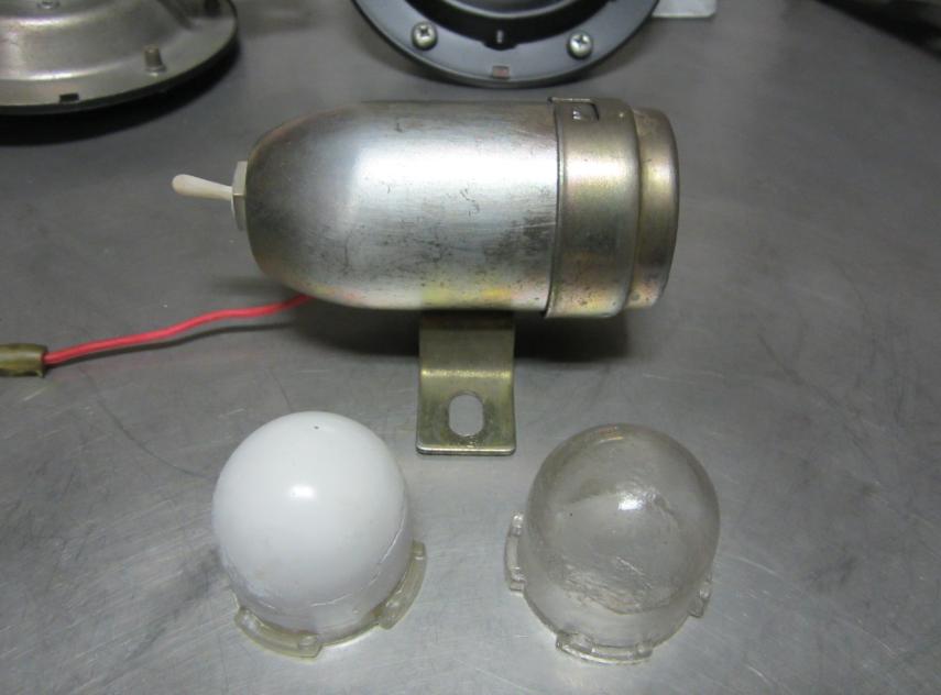

How would it look with a light coating of off white spray paint applied to the inside of the lens?
Dennis
Dennis
I will try to experiment with some white paint. It would be better to spray the inner part of the mould and let the resin bond to it. It would need to be a very light coat though and getting it even may be a challenge. White dye in the resin is also an option.
