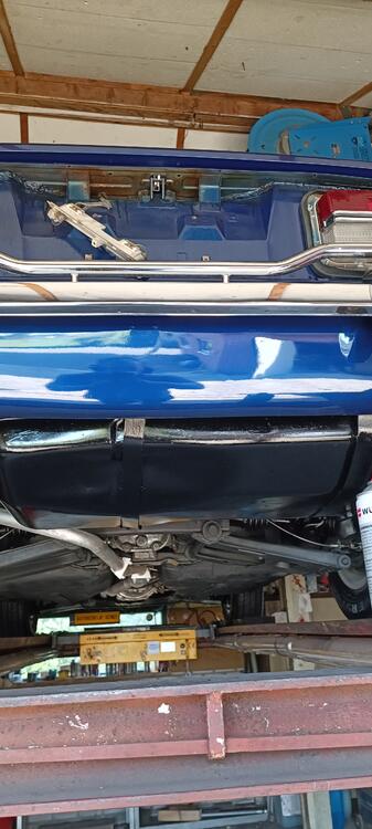

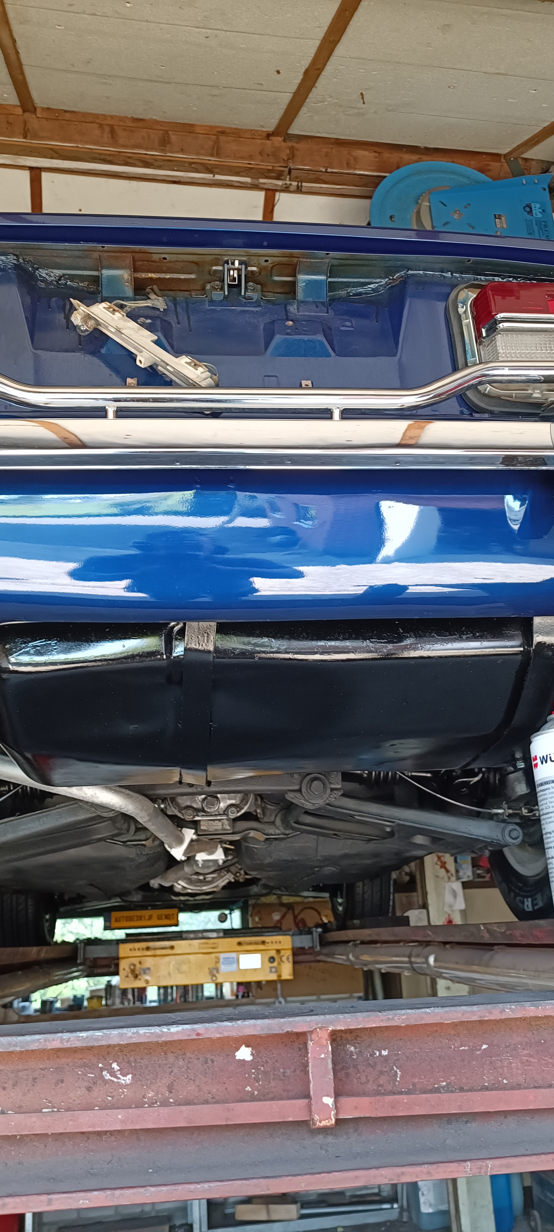

280 nos belt is on. Seems fine to me...

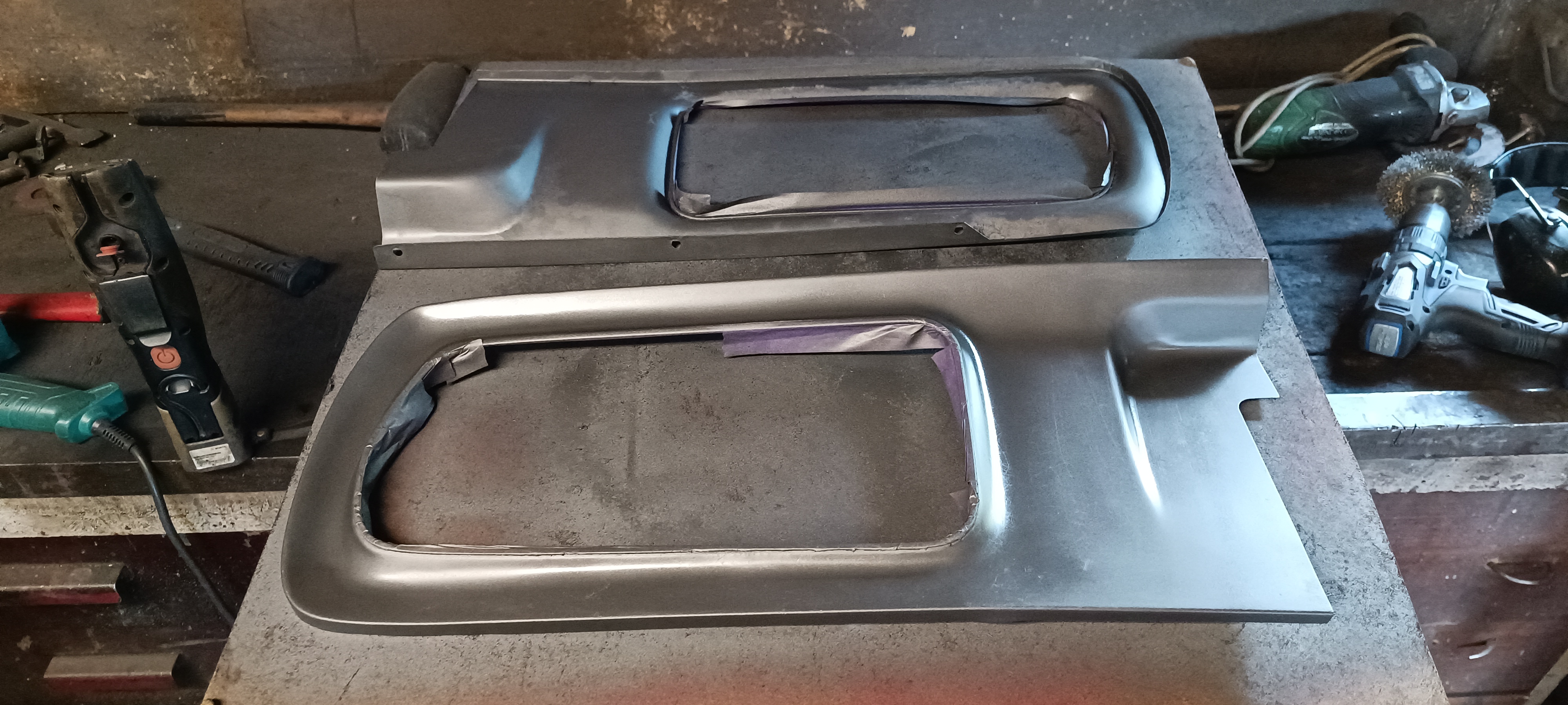

Removed the taillight panel to get that original look and treat surface rust beneath the rear panel...
