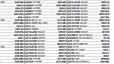

February 6, 201411 yr comment_441177 Hi Bart, Sent you a PM, but thought it might be handy for others to post the wheel bearings info here as well. When I did mine two years back, I ordered the bearings from Nissan and they sent SKF bearings in Nissan packaging. Bearings: Inner: Nissan p/n: 43215-E4100 (Nachi RLS10-C4) --> SKF GRW116 Outer: Nissan p/n: 43210-E4100 (NSK B31Z-16C4) --> SKF GRW117 In brackets is what came out of my car. Oil seal Nissan p/n: 43232-E4100 (€5,45/ea) There is not many manufacturers making the outer bearing these days. Warning: Only use the C4 tolerance bearings. The C3 bearings (smaller tolerances) will run much hotter and wear out quickly. See attachment for SKF catalog. You can search the PDF. Just use the first numbers, eg: 43232 and keep searching till you find the Nissan part number you want. With the SKF number you can find other manufacture of you choice. The raer wheel bearings are on page 315 (screen shot). Succes Chas SKF_Catalog.pdf Link to comment https://www.classiczcars.com/forums/topic/45423-my-datsun-240z/?&page=17#findComment-441177 Share on other sites More sharing options...
