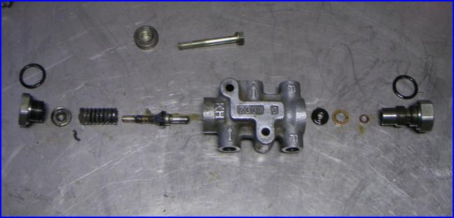

Im rebuilding all the brakes on my 280Z and now I am at the NP-valve (Proportioning valve) and the Brake indicator switch. The parts are ok, but I would like to replace all the seals.
The NP-Valve is still availible at Nissan under P/N: 46400-P9200 but it cost $325,00. The Brake fail indicator switch is also only available as a complete unit. Internals are NLA. All I want are the internal seals and o-rings.
Does anybody know where you can get the kits these days?

I would go to a parts store and match up the o-rings. The parts here locally have trays of o-rings for 'free-style' fitting. I am pretty certain it will be that way where you are too. It might be tricky to find the little one on the little plunger inside the housing. I think it is great you went the extra step to actually remove and repair the Proportioning Valve - most people ignore it. I am glad that you posted pics too, that will be good for the future. Let us know the outcome!

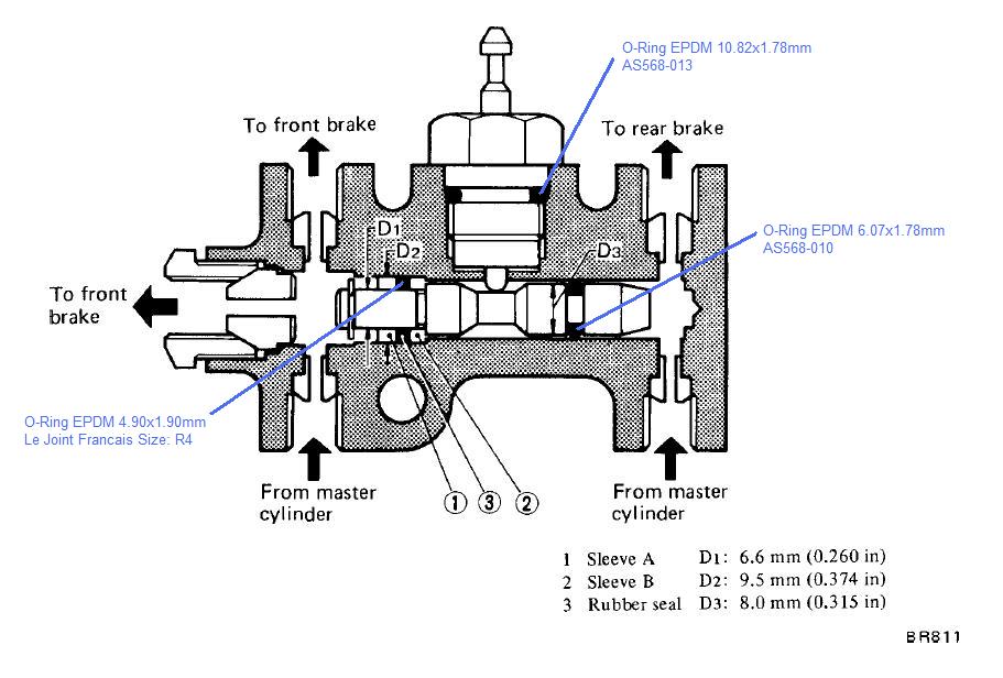

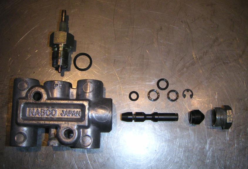

Finished rebuilding my brake switch. Luckely the bore was not too bad and cleaned up nicely with 500 and then 1000grit wet&dry. Made a hone out of a BIC pen by cutting a slot in it and using a 10mm strips of wet&dry.
280Z Brake Switch:
(The sizes are ID x Cross section. The material is EPDM)
The shuttle has two O-rings.
1x 6.07x1.78mm. AS010
1x 4.90x1.90mm. R4
The brake switch has an O-ring seal
1x 10.82x1.78mm. AS013
Proportioning Valve:
Not much luck on finding any replacement parts for it. I did find some cups that fitted, but the brake workshop didnt know which old car they came from. He just had a box of loose ends he kept out the back. He said, If I could find anything I could keep it.
Chas

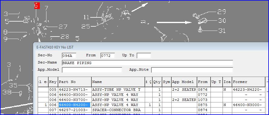

The last I have heard is that the np valve is now nla. I managed to clean mine up and reuse it. The switch just needed a set of o-rings. Its been 1 1/2 years and they are still working fine.
