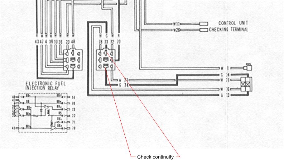

SteveJ Posted January 25, 2013 Share #6 Posted January 25, 2013 The positive wire for the 76 (and the 75) fuel pump comes from a green/blue wire. That wire originates at the Electronic Fuel Injection Relay pin 74. In the relay, pin 74 gets power from pin 73 (white/red wire) when the coil is energized. The coil in the relay is energized when either pin 76 or pin 4 have 12 VDC. Pin 76 is connected to the START circuit of the car. Pin 4 is connected to the ECU. Pin 4 has 12VDC when the AFM contacts are closed. (See EF-12 and EF-15 in the FSM) If the fuel pump stays on after you turn off the key, unplug the fuel pump relay and look for continuity between pins 73 and 74 on the relay. The attached drawing shows where the pins are on the base. Look for the green wires running to the fuel pump relay base. If you have continuity, that means the contacts are probably welded shut. Also check for voltage from Pin 4 on the relay base to ground. Measuring 12VDC is bad. Please note that I don't know if unplugging the relay would reset the signal from the ECU. The good news is that if you have a bad relay, apparently they are not that expensive. Link to comment https://www.classiczcars.com/topic/45466-running-rich-fuel-pump-constantly-runs/#findComment-412963 Share on other sites More sharing options...
Cethern Posted January 27, 2013 Author Share #7 Posted January 27, 2013 Zed Head, yes I took resistance measurements, they were within spec as per the manual. SteveJ, thanks for the info, there is continuity, I put a 9 volt battery to the terminals and was able to get both coils to click, I would take that as a good sign that the coils are not stuck closed. As of now the car barely runs if you can call it that, and is back firing out the exhaust, I picked up a timing light and haven't gotten the damn thing to light up to even see if the timing is off, but if I pull the plug and hold it about. 1/2 in away it will bridge the gap. Thanks again for the help Link to comment https://www.classiczcars.com/topic/45466-running-rich-fuel-pump-constantly-runs/#findComment-413248 Share on other sites More sharing options...
