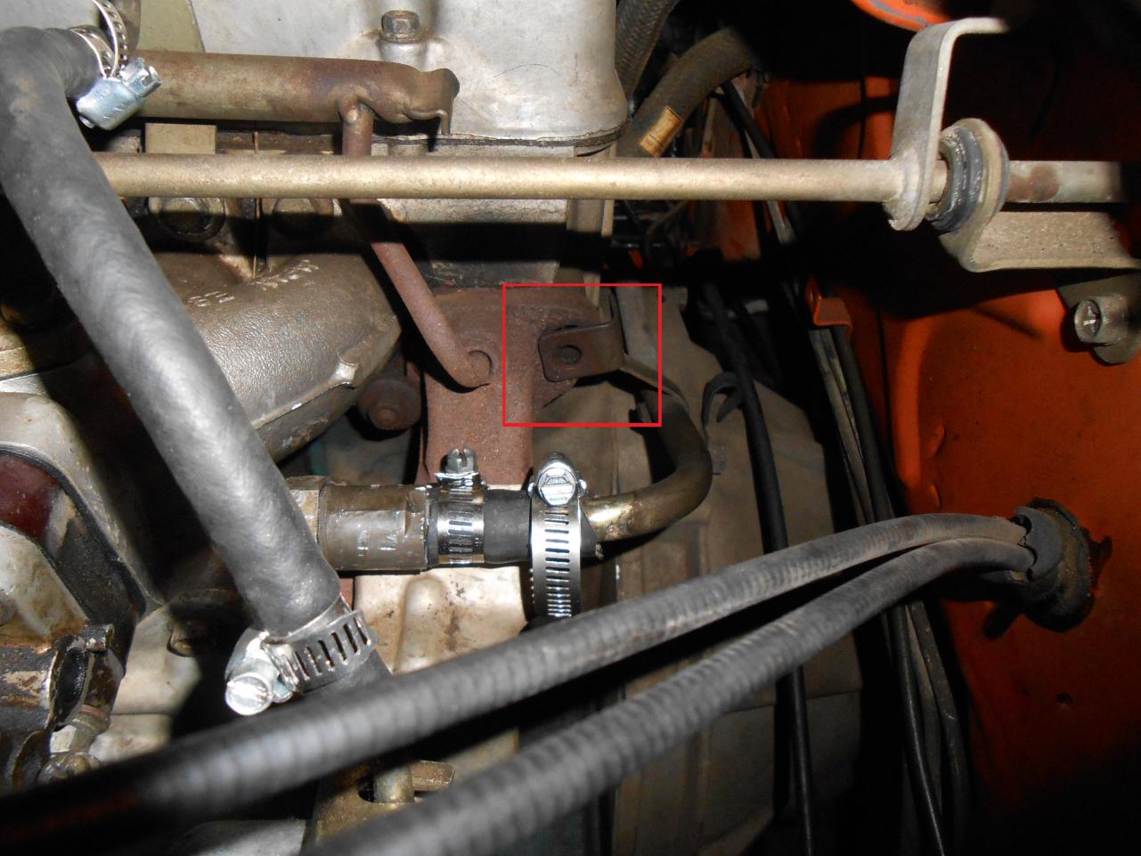

NCdatsunZ Posted January 28, 2013 Author Share #3 Posted January 28, 2013 When I was looking for smoke in the engine bay I noticed a bolt wobbling around in this spot. I tried to tighten it back down but it snapped leaving the stud buried inside the engine. Would I be able to limp it to my mechanic in this condition? Link to comment https://www.classiczcars.com/topic/45519-smoke-coming-off-the-exhaust-manifold/#findComment-413277 Share on other sites More sharing options...
Zed Head Posted January 28, 2013 Share #4 Posted January 28, 2013 That was an exhaust manifold mounting stud. They break a lot. There are many Z's driving around right now with that stud broken. It shouldn't hurt to drive it a shop. Bummer, but it was probably already half-broken when you tried to tighten it. They crack and break from metal fatigue after a few tens of thousands of heat cycles. Link to comment https://www.classiczcars.com/topic/45519-smoke-coming-off-the-exhaust-manifold/#findComment-413279 Share on other sites More sharing options...
SteveJ Posted January 28, 2013 Share #5 Posted January 28, 2013 You should be able to get it to your mechanic, but beware of exhaust gasses coming from the engine compartment. You don't have to drive far, do you? Link to comment https://www.classiczcars.com/topic/45519-smoke-coming-off-the-exhaust-manifold/#findComment-413281 Share on other sites More sharing options...

ZCurves Posted February 4, 2013 Share #7 Posted February 4, 2013 If it is not leaking, leave it ALONE! Is there any of old stud hanging out that you can see? This will be a good opportunity to learn in the future. If you take it to a mechanic - the only thing smoking might be your wallet! Consider repairing it yourself, there are plenty of us to help. Link to comment https://www.classiczcars.com/topic/45519-smoke-coming-off-the-exhaust-manifold/#findComment-413919 Share on other sites More sharing options...
rcb280z Posted February 4, 2013 Share #8 Posted February 4, 2013 Soak it with some penetrating oil and drill it and "easy" it out. Then you can replace it with a new one. Link to comment https://www.classiczcars.com/topic/45519-smoke-coming-off-the-exhaust-manifold/#findComment-413923 Share on other sites More sharing options...
mjr45 Posted February 10, 2013 Share #9 Posted February 10, 2013 Its a pretty simple job even with the manifold on. I replaced the same bolt on mine long before I pulled the motor when I replaced all of them. I don't know about the 240 but on a 280 there is also an engine hoist hook on that bolt. Link to comment https://www.classiczcars.com/topic/45519-smoke-coming-off-the-exhaust-manifold/#findComment-414541 Share on other sites More sharing options...
NCdatsunZ Posted February 10, 2013 Author Share #10 Posted February 10, 2013 There is absolutely no bolt showing and it's not leaking so I'm going to just leave it there for now. Later on down the road I will probably pull it out. At this point I'm in "get it on the road" mode so I'm not too worried about it right now. Link to comment https://www.classiczcars.com/topic/45519-smoke-coming-off-the-exhaust-manifold/#findComment-414565 Share on other sites More sharing options...

FastWoman Posted February 11, 2013 Share #12 Posted February 11, 2013 (edited) Dunno... I see carbon deposits on the head right above the #6 exhaust port. To me that says there's a leak, which is not all that uncommon on these engines. The hazard of having a slow exhaust leak, particularly on an aluminum head, is that the exhaust gasses can slowly erode away the metal, particularly if you also happen to have a lean fuel/air condition. Also carbon monoxide will be wafting around in your engine compartment, and that can make its way into the cabin. This may not be an URGENT repair, but it's probably one you should consider making soon. Until then, you should probably drive with your windows cracked. Edited February 11, 2013 by FastWoman Link to comment https://www.classiczcars.com/topic/45519-smoke-coming-off-the-exhaust-manifold/#findComment-414672 Share on other sites More sharing options...
