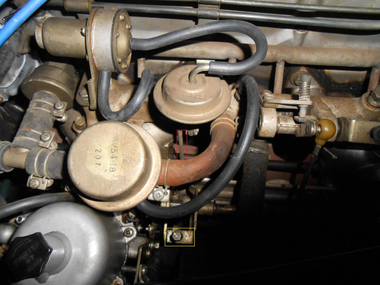

Quick question. The rod outlined in red doesn't move even with the engine running. Is it supposed to move? It is keeping the thing outlined in yellow from moving as well.
Might this cause the problem? Would it be wise at this point to delete some of the stuff on the balance tube like I have seen others do?

Have you downloaded a copy of the factory service manual yet? You can find them here: XenonS30
The rod outlined in red doesn't move even with the engine running. Is it supposed to move? Might this cause the problem? Would it be wise at this point to delete some of the stuff on the balance tube like I have seen others do?
No.
Tell you what... If you can provide the name that the service manual calls the round thing with the black tube attached to it that's above your red outlined rod, then I'll tell you all about what it does. :)
