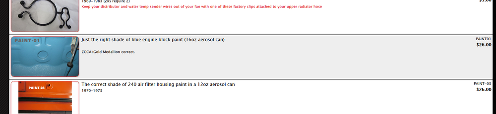

I realize this is a 6 year old thread, but @zspert does carry the correct color for you all.
http://www.zzxdatsun.com/catRequests.php
EDIT: @EuroDat @Arne already mentioned Banzai, I did not fully read the thread prior to posting. My error.

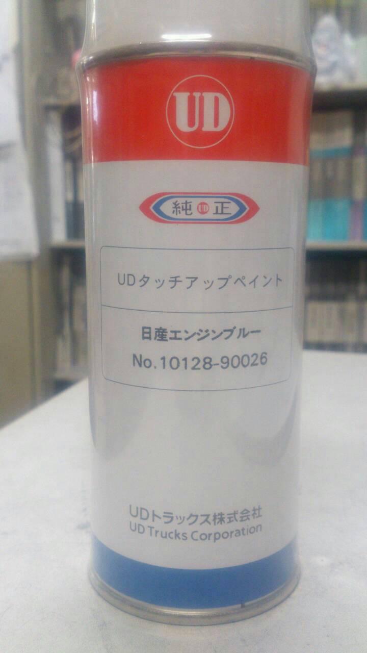

Hi , I have neither  used nor confirmed color of this can but most of L - series engine builders say this is the color , and still available from a local Nissan today .
I just bought one for my curiosity. The label said
“ genuine “
“ UD touch up paint “
” Nissan Engine blue “
” No 10128-90026”
I googled little bit, UD is a company for trucks, Volvo is a parent company. Nissan diesel Ltd was merged  into Volvo in 2007 .
Hope this helps .
Kats

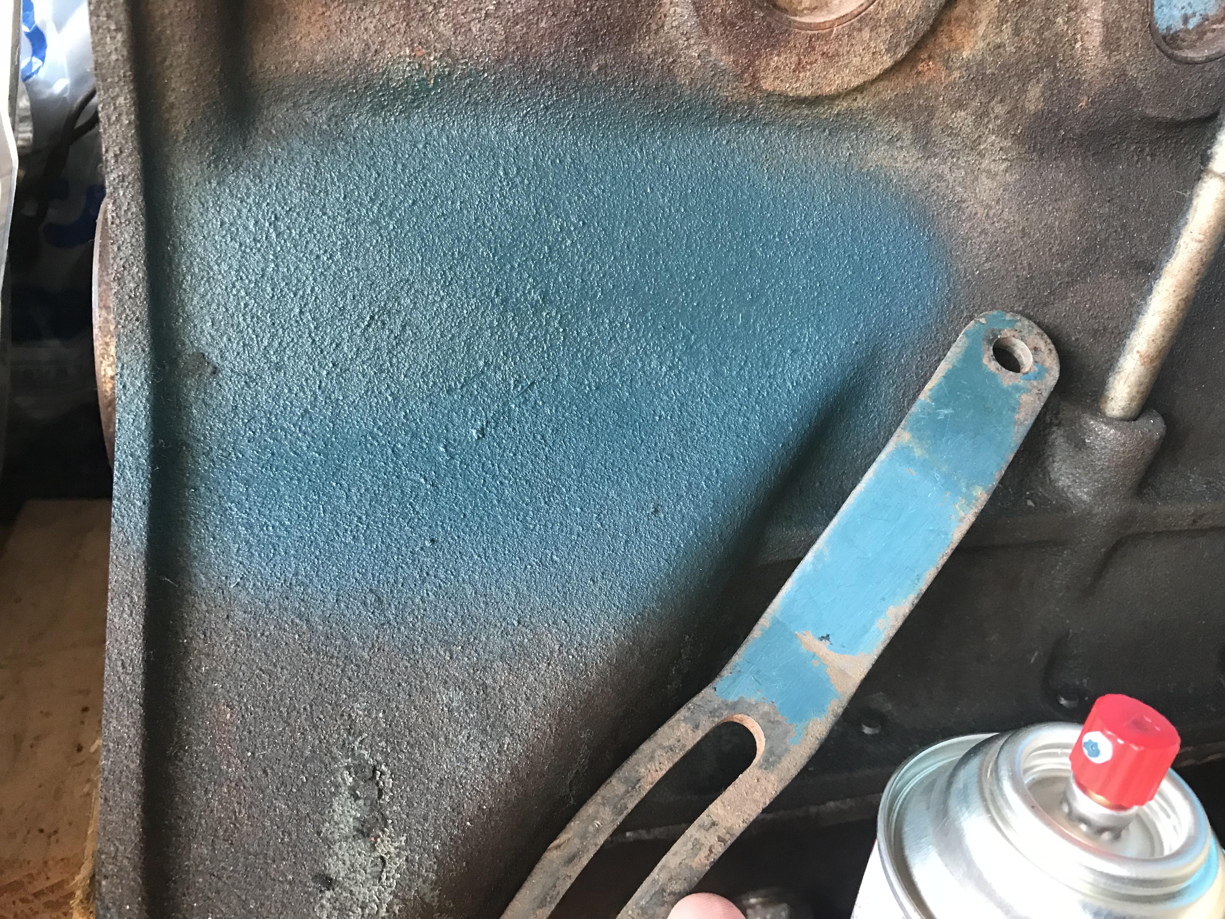

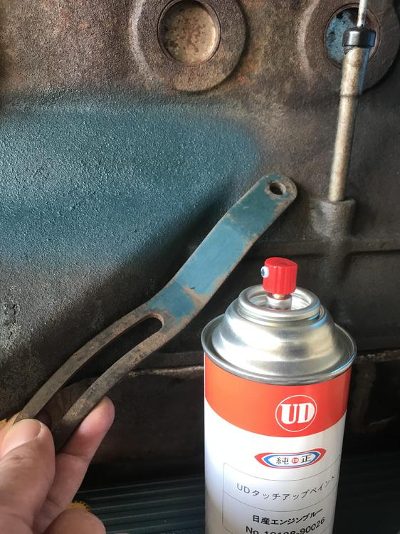

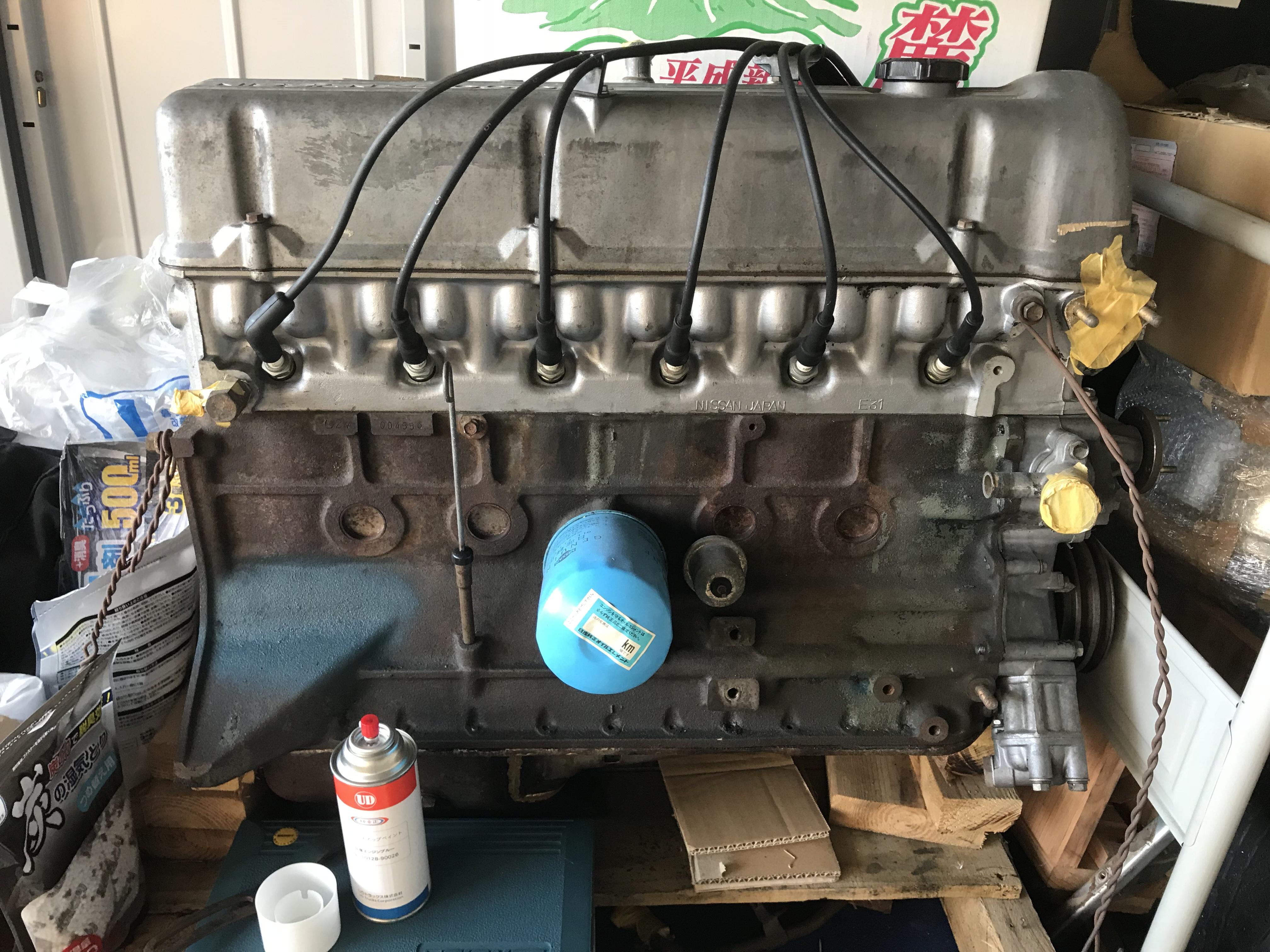

Today I painted the can to see how the color look like . I sprayed it on my spare
L24-004556 , just a little bit right side  rear end .
In the picture, I held an alternator bracket side by side for a comparison . This bracket is the original , never  repainted In the past .
I see the can color is  a little bit different from the bracket, but I see the can color matches perfectly to the original engine block which is in my orange 1972 240Z , never repainted in the past .
Kats
