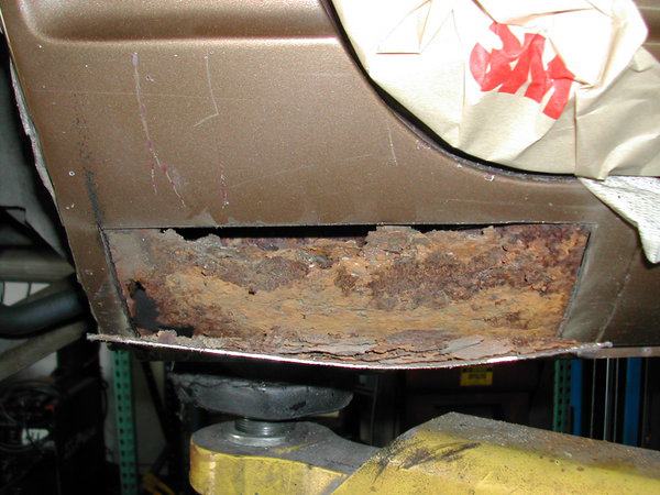

I've repaired probably 30 rusty 240Zs over the years and many have been after the owners sprayed POR15, Rust Stop, and many other rust fixers, encapsulators, penetrants, waxes, etc. trying to stop the rust. None of them worked. In fact, they just added to the cost of the repairs because I had to get all that crap off the good metal to do any welding.
Here's a picture of one that had a bunch of rust inhibitor sprayed in the rear of the rocker and up over the wheel well. All it did was stick the rust together.
