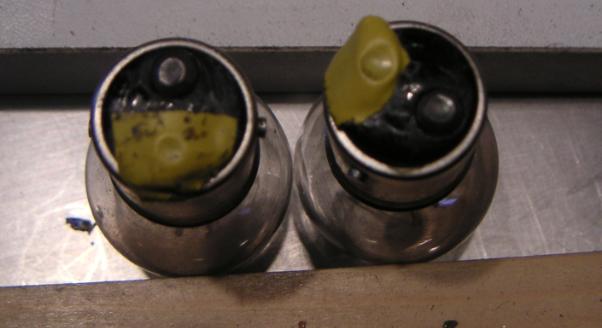

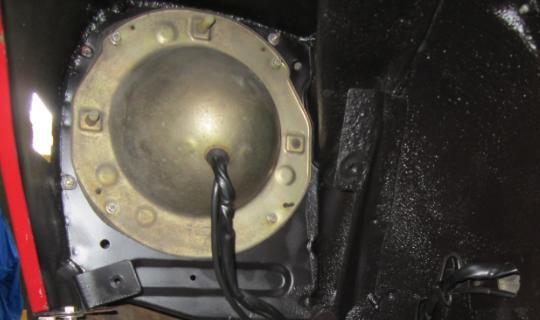

The parklight had to be wired into the headlight as you can see the extra cable to the headlight. To remove the parklight function from the indicator I just taped the connection on the bulb. That way I didnt need to cut to much wiring.
