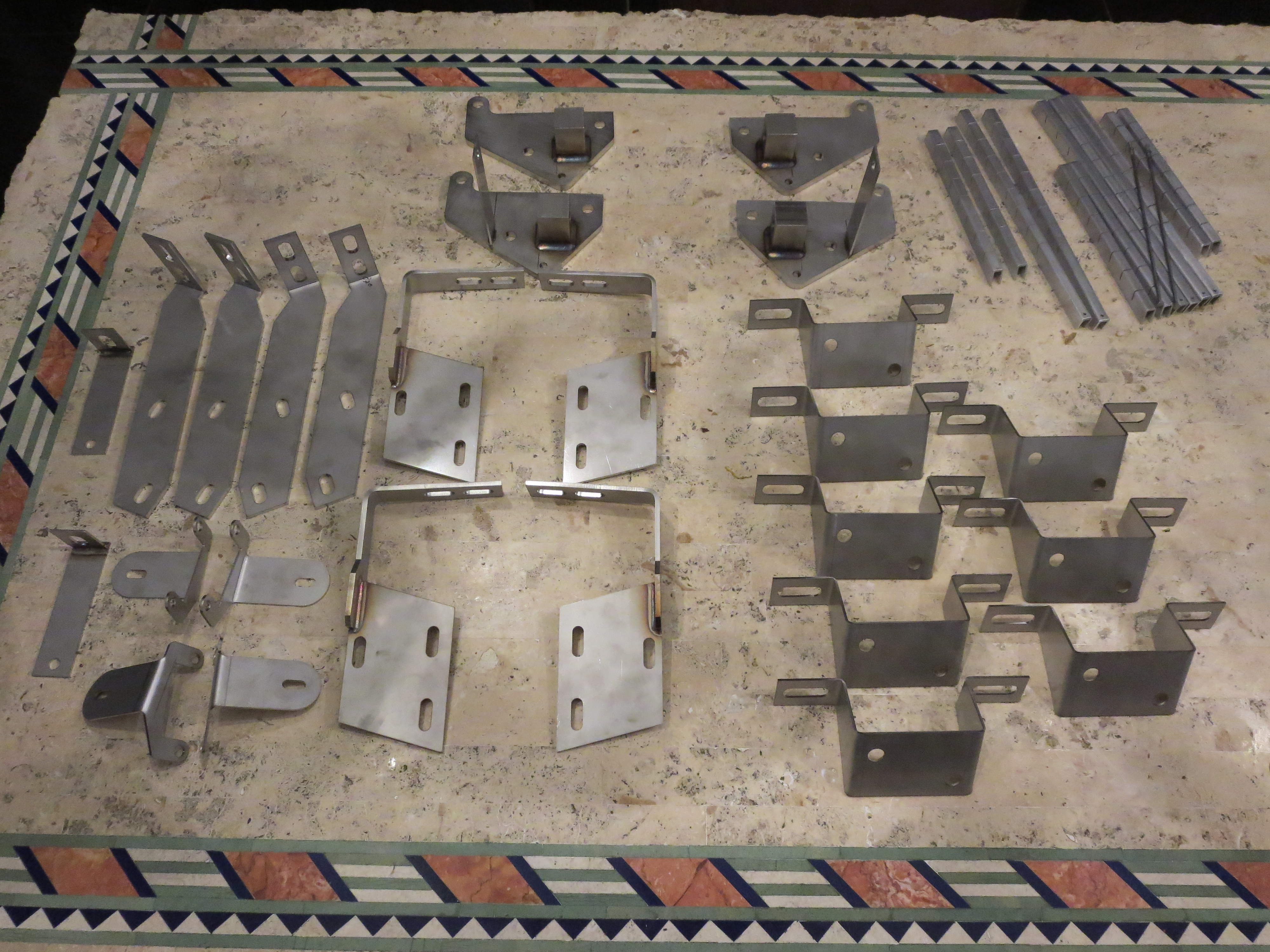

This evening we finished the first set of brackets. Still need to pickle the welds and test fit everything to make sure everything fits as it should.
Here is a photo of the brackets. Still waiting for bolts and nuts I ordered a week ago. M10 with a 1.25 pitch doesn't seem to be that common. Especially in grade 10.9. I ended up ordering 8.8.
Tomorrow Ill fit the brackets and make step by step photo's. For now I'm just going to crash on the lounge and have a beer.
