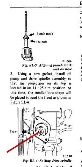

So, you're saying that either, somehow, the distributor shaft was forced in to the wrong orientation in the beginning or you forced it in to the wrong orientation to make it work. As designed it will only install one way, since the aligning slot and its counterpart are offset to one side. You would have to put some effort in to get it jammed in the wrong way, I assume. When you say that you flipped the "oil shaft" do you mean the distributor drive shaft? Or did you remove and reinstall the oil pump?

I dropped the oil pump and re-inserted the oil shaft at 11:25 but with the small moon towards the back (rather than the front as it seems most cars are). It then matched up with the distributor that had the small moon towards the back.

that looks like 12:30 to me not 11:25. i was thinking about trying this position because the least amount of advance i can get is about 12-14 degrees.

Blue's looks a lot more 11:30-ish than mine, but all I can say is that my car runs well, my timing is correct, and I've got more than enough adjustability fore and aft from where it belongs. So maybe mine is off one tooth, but I can still get it timed? Maybe it's a camera angle issue?
Biggest issue to check is that the factory service manuals says that when at TDC#1, you should have the smaller bow shape should be placed toward the front of the car. That's what you have now, right?
No; mine doesn't look like that; mine has the small moon towards the back.
The picture is from the bottom of my distributor; you see that the small moon is towards the back; so in order to match that up, I flipped the oil pump shaft so that it would match the dizzy.
I didn't take a picture of the oil pump shaft after I flipped it; let me know if you would like a picture of it; I'll pull it for you.
