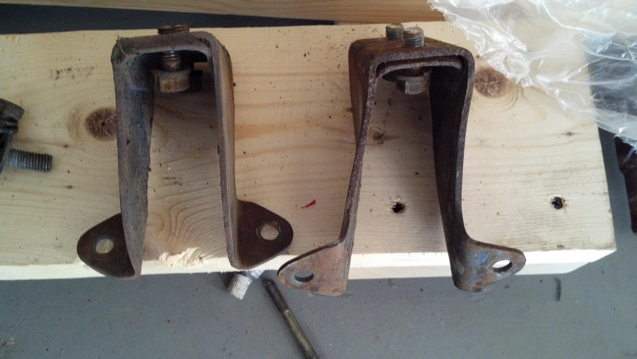

I've done too much work so far to cut corners and try to use 'straightened' motor mount brackets. Likely was bent when pulling the motor. Anyone have a spare set lying around? My eBay options start at $80, which seems extreme considering the number of parts cars lying around. Nearest junkyard that I know will have them is nearly 2 hours away. Should have addressed this a long while ago.
I just took a better look at the mounts from the ZX, and the are not the same. The later brackets have a gusset welded in the center to... well... prevent exactly what happened to yours. :) I suspect they bolt up identically, but if you're looking for concourse replacement, then what I've got is off the table.
Here's one of the ZX mounts
PS - My 77 also has the reinforcing gusset, so they figured it out some time before 77.

My 73 240Z has the open brackets. My 74 260Z and 75 280Z both hav ethe closed brackets. From what I can tell they are interchangeable.
To the OP: I have a set of the open brackets you can have. Send me a PM if oyu still need them.

Capt. Obvious reached out yesterday with a set of the reinforced brackets. These are going on my '71, which should (fingers crossed) put down 200-210 hp at the wheels, so the reinforcements are likely a wise upgrade.
