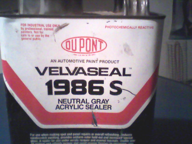

My windshelid in my daily driver (Chevy S10) was leaking, I found some +20yr old seam sealer in the garage. worked like a charm!
Attached is a pic of the can (I doubt if the label is the same, but I'd bet they still make this stuff)
Pretty sure I saw a similar seam sealer product from Eastwood.
I think the stuff I used was intended to be sprayed on, but I used a brush and allowed it to flow into the areas that were leaking. It's been over 6 months and no leaks!
I'm sure the stuff can be painted over, but as so far I'm just tickled it's not leaking!
