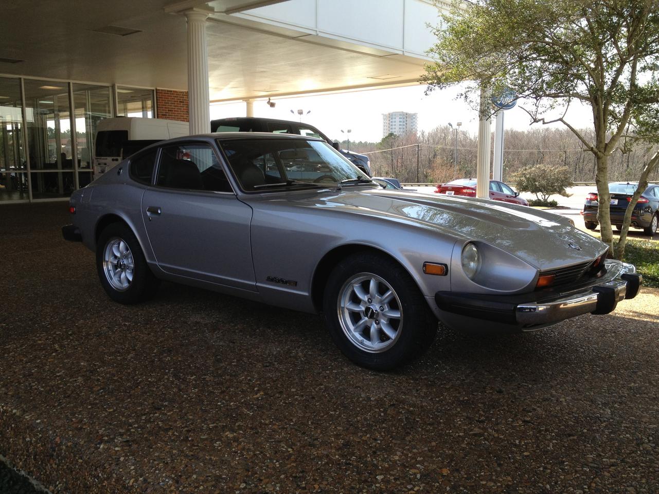

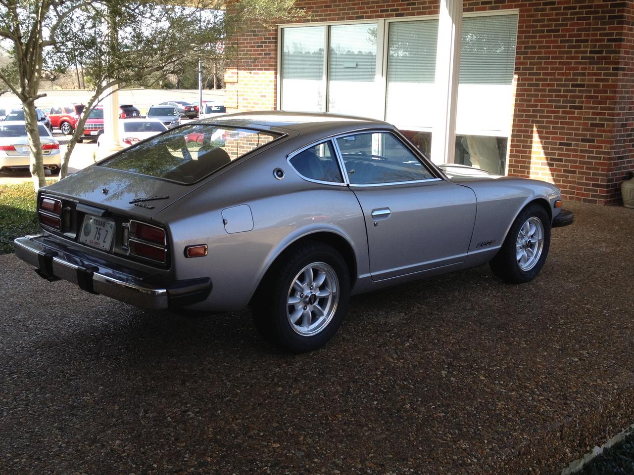

I bought what I think was a really nice 75 280 last year. A represented 39K mile, nearly original, nice car. After climbing all through it, I believe that it is a real 39K mile car, but who knows, after 10 years, it's exempt on miles in Texas anyway. It has been painted, but the work was done very well and it has absolutely zero rust, or prior rust repair. It had what I think were some old Panasport knockoffs, fronts were 14x6, rears 14x7, taller tires on the rear, looked like hammered crap. Seller said they were Panasports, had the blue Panasport center caps, at least 3 of them did, the 4th the same blue raised decal but was a different cap, held in the wheel with duct tape by the way. Regardless, I didn't like them so I then went and refinished a set of original 14x5's with 195/70's and hubcaps and installed them, if it's possible, it looked worse (in my opinion).
Finally, I decided on where I am now, 15x6, 15mm offset, real Panasports, 205/60R15 tires, seems to fit very well and looks good to me.
