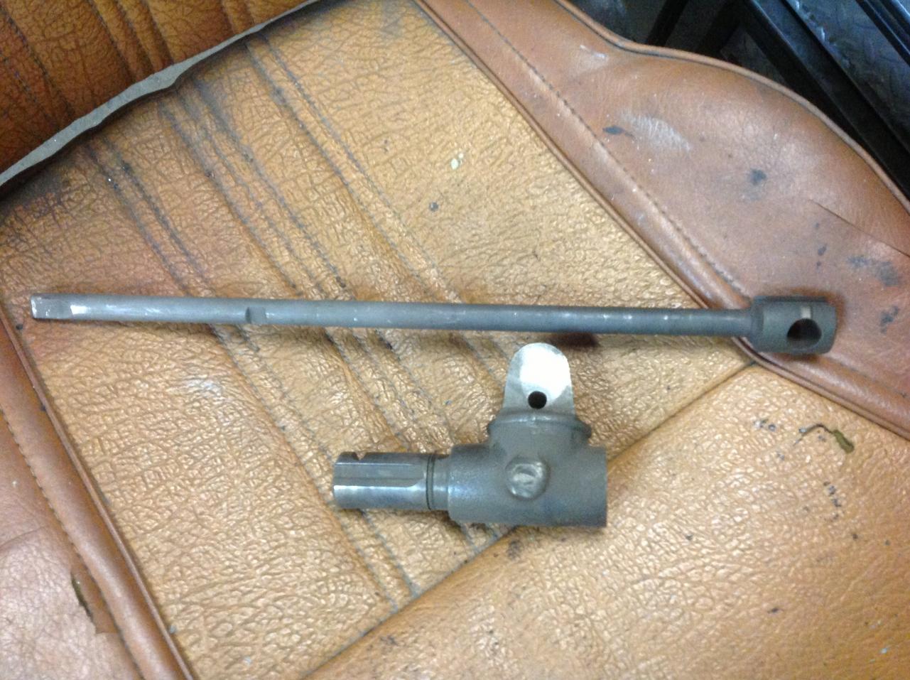

Funny, when I took pictures the other day for this thread - http://www.classiczcars.com/forums/engine-drivetrain-s30/48693-shifter-return-spring.html - I spent some time myself trying to figure out how to remove the pin. Ended up using an aluminum rod stuck through the reverse check sleeve hole to drive it out.
I'm not really in to selling or shipping parts myself but there's a member here called borini63who sells a lot of parts. Might be worth a note. He posts often on zcar.com and hybridz.org also. Seems fair and reasonable from what I've seen.
https://www.classiczcars.com/topic/45815-striking-rod/#findComment-416053
This is the remains of a scrapping of a dead late 5speed about 2 years ago. I salvaged the shifter ears to design/test short shifters, so had to take that nasty pin out to get the shaft out. Since this thread got posted I've thinking "dang I know I kept the ears part, but I must of tossed that shaft, didn't I??" I finally went to look, and guess what I found!!!
That and I have more Z bits laying around than I know what to do with....
