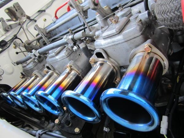

This is the picture of the air horns. They are from a very well known Japanese tuner and built for mikuni 40. These are on a hako (skyline)
info so far:
Kameari carb manifold : 5 inches
Air horns : 4 inches
Mikuni 40 : ?? inches
I love those horns simply because they fully are radiused at the ends! I've been recently thinking about modifying my air horns to give the ends a full radius since I hadn't seen long, radiused horns for triples. Maybe I won't have to...
info so far:
Mikuni 40's are a hair under 5"
There's also EFI hardware who make these stacks, 105mm long but can be shortened anywhere between 105-60mm. They have a full radius bellmouth and a tapered bore, starting at 79mm o.d. The bases are removable so you can shorten the stacks with no issues.
These are their 40mm stacks to suit weber, dellorto, mikuni. Very well priced too.
