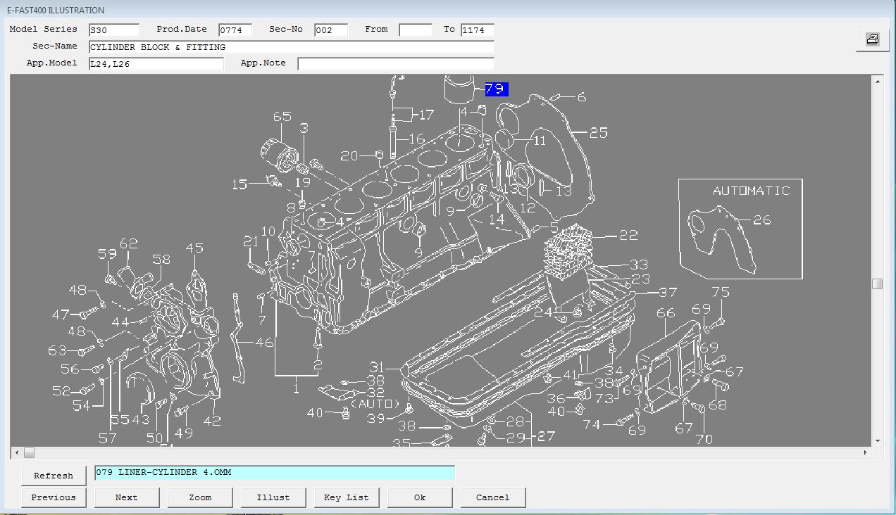

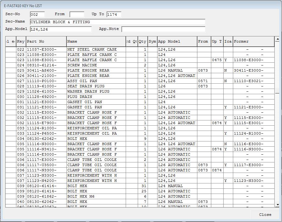

EuroDat Posted February 28, 2013 Share #4 Posted February 28, 2013 Called Nissan to ask for the seal but they have two different part numbers: 12279-2B500 and 12279-R4611. I have a 260z block - any opinions about the right part number?Thanks. The part numbers you are quoting dont match the original E-Fast system. The E-Fast system is quoting 12279-21003, 12279-21010 and 12279-R4600. The number 12279-R4600 was changed to 12279-R4601. Link to comment https://www.classiczcars.com/topic/45871-rear-main-seal-part-number/#findComment-416500 Share on other sites More sharing options...
