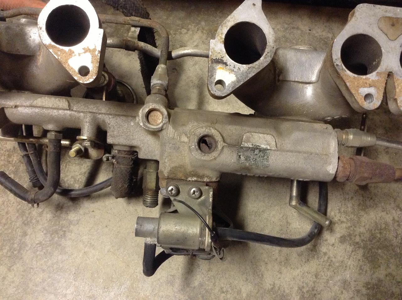

I have a theory, I also have a early 260, and I had a rough idle, not as smooth as I would like. I have since taken everything apart and discovered why. Under the intake manifold there are a few plugs that are rusted out see pics. There are two between the head and the carbs; and two directly under the carbs. Check to make sure these are in place. -- Justin
and

Sorry my bad, the first pic shows the plugs that are in the bottom of the intake manifold, directly under each carb, about the size of a dime, these look like small block freeze plugs. I also have a plug that is rusted out, center of second pic, not the brake booster pipe. My theory is the plug directly under the front carb is rusted, leaking or missing causing cylinders 1, 2 & 3 to not operate properly. --Hope I explained things better - Justin
