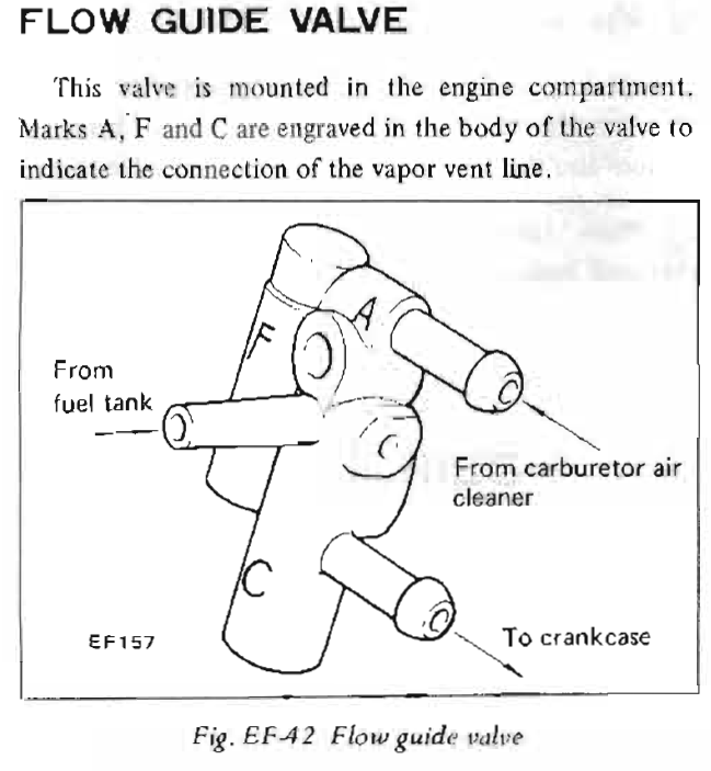

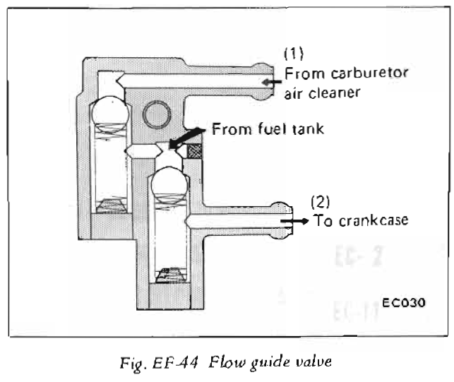

And also I'm confused what's the function of the part that's under the coil, pictured? I assume 1 hose went to what the picture shows? But the other connection seems closed anyhow? Anyone some information on this?

The coil wiring looks and sounds right off the top of my head. The 3 way vacuum hose bit is part of the gas tank vapor recovery and crank case ventilation system, it's hooked up like so:
[ATTACH=CONFIG]61718[/ATTACH][ATTACH=CONFIG]61719[/ATTACH]
