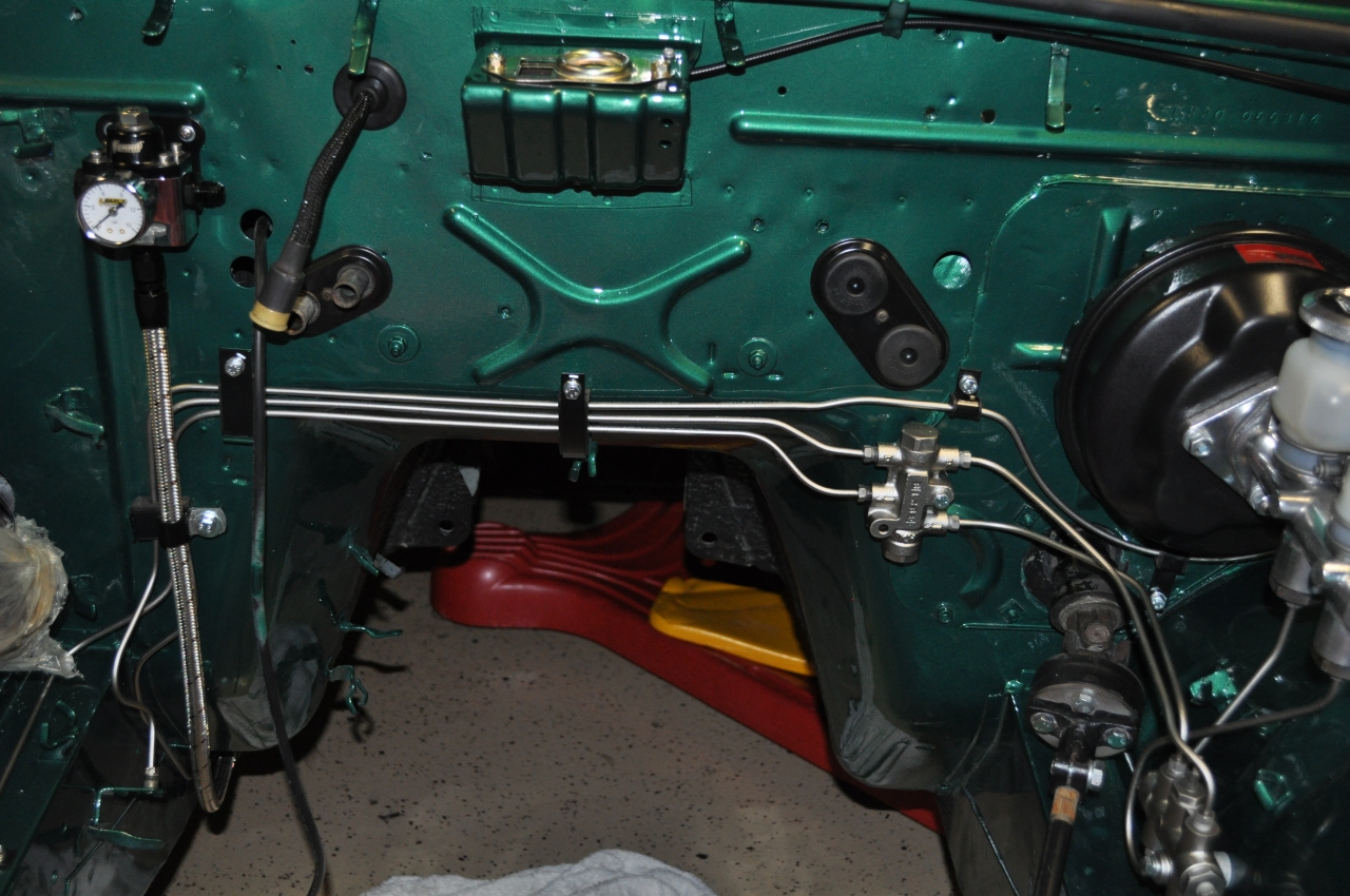

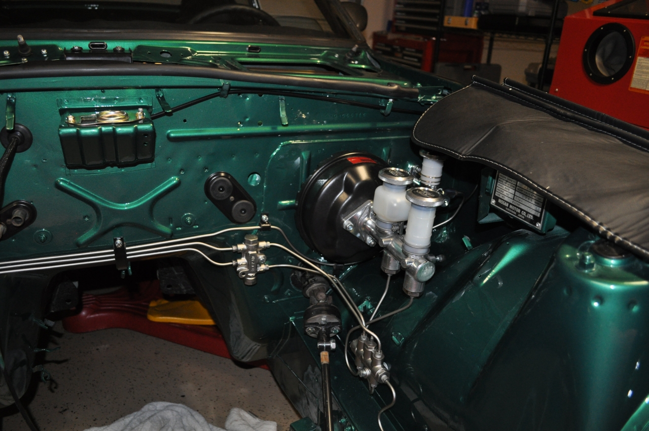

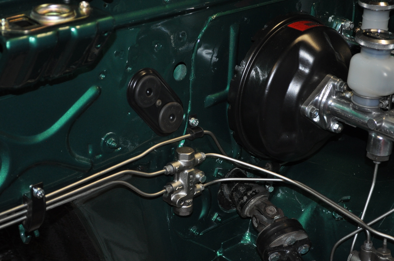

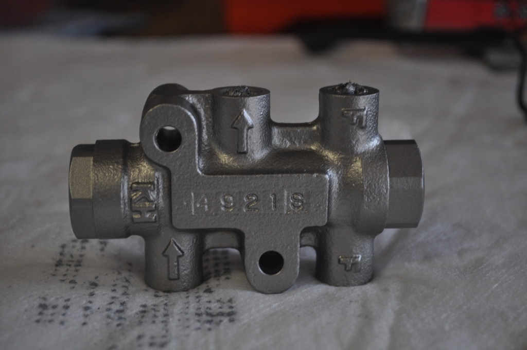

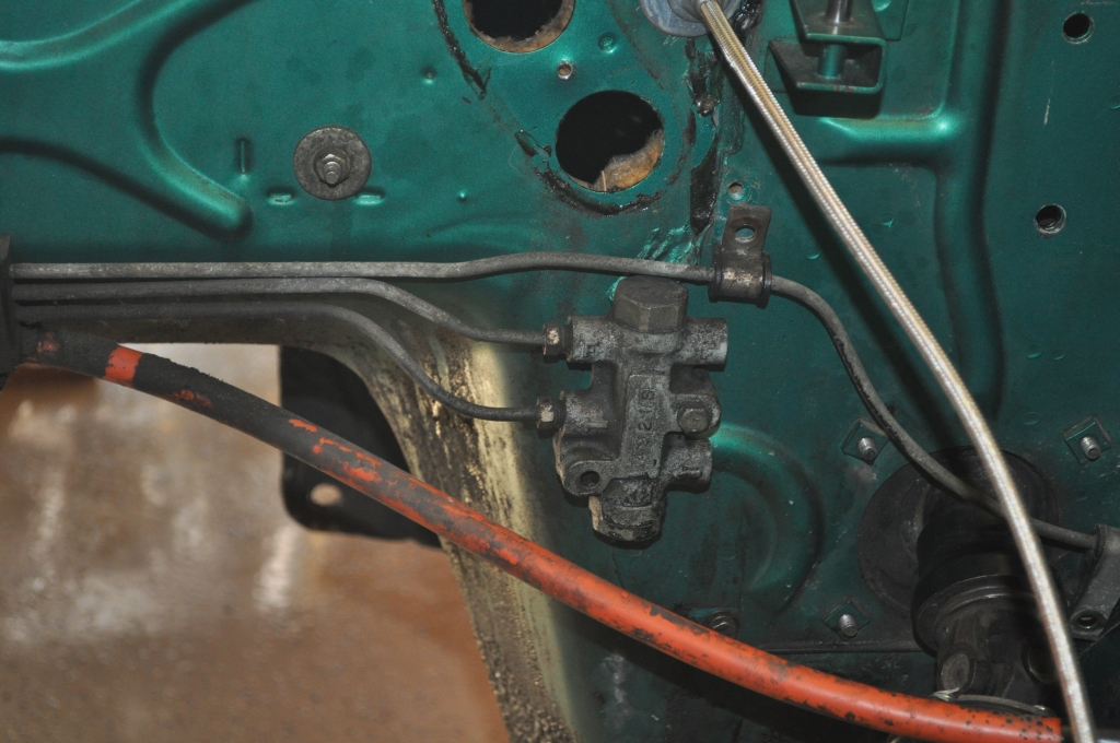

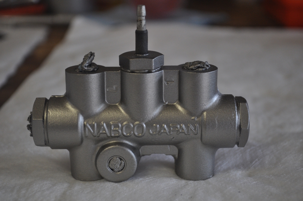

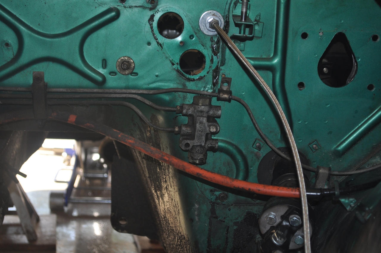

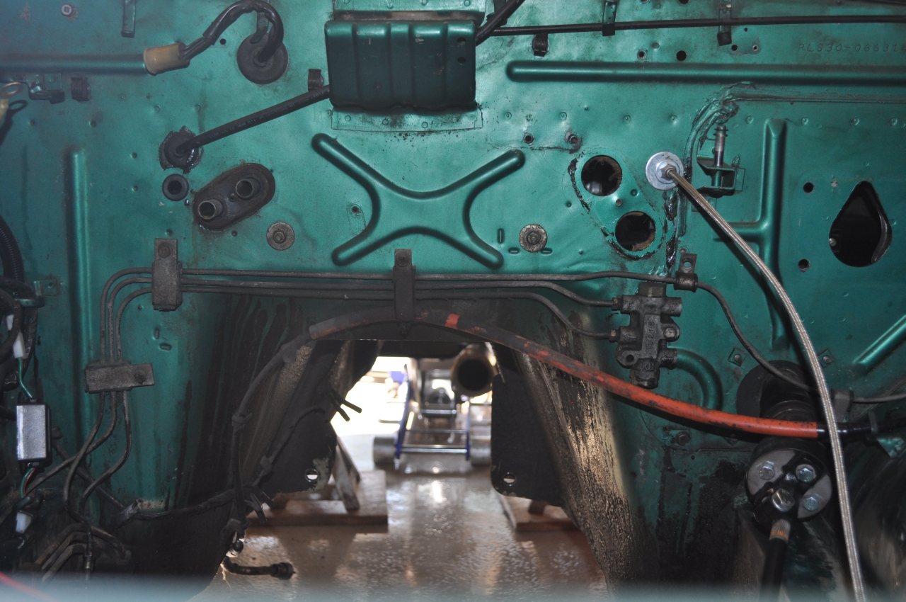

I had the same dilemma when I refreshed my engine bay last year.
I ended up removing all of the brake lines, cleaned and sanded them thoroughly, and painted them with a product from Eastwood called Eastwood Brake Gray which is supposed to be brake fluid "resistant". I've attached a few pictures so you can see the before and after of the brake lines. I am very happy with the results.
As far as the fuel lines are concerned, I ended up ripping them all out and replaced them with a single run of AN6 hose that goes from the rear fuel pump all the way up to the engine bay and finally to my Weber carbs. Much better and cleaner than the original fuel line setup. I also do not use a return and have never had any issues with this arrangement.
