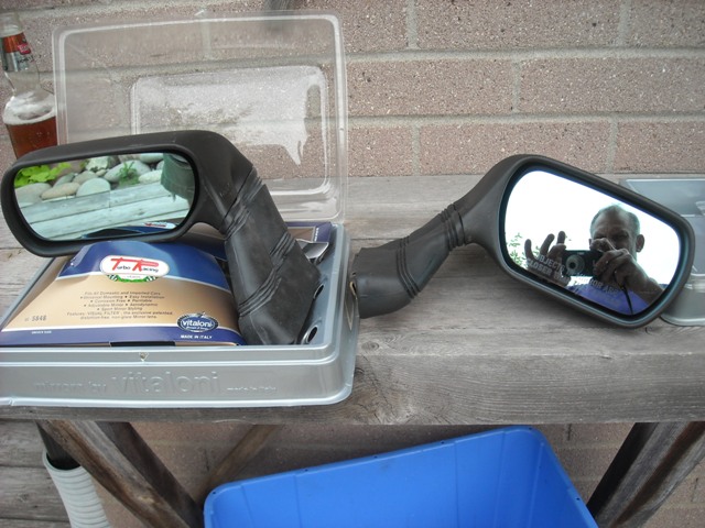

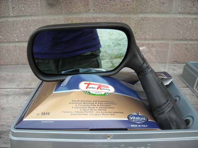

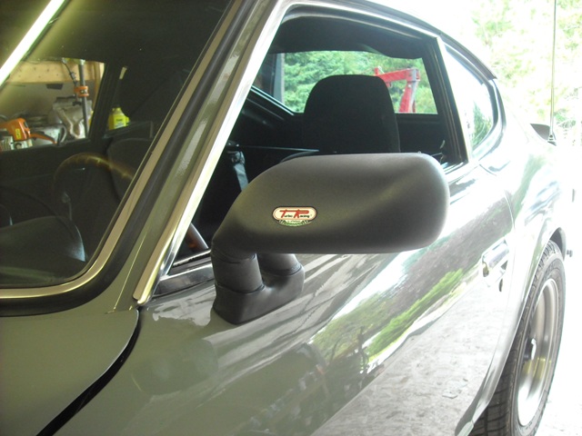

I bought my Vitaloni mirrors mostly because of this thread and I hated all the other mirrors I looked at.
I got them on ebay for $100 plus $21 shipping, honestly I wasn't expecting too much because the of the reasonable price.
I'll post the name of the seller if anyone wants it, good guy.

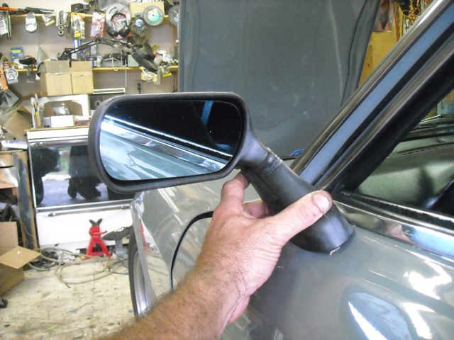

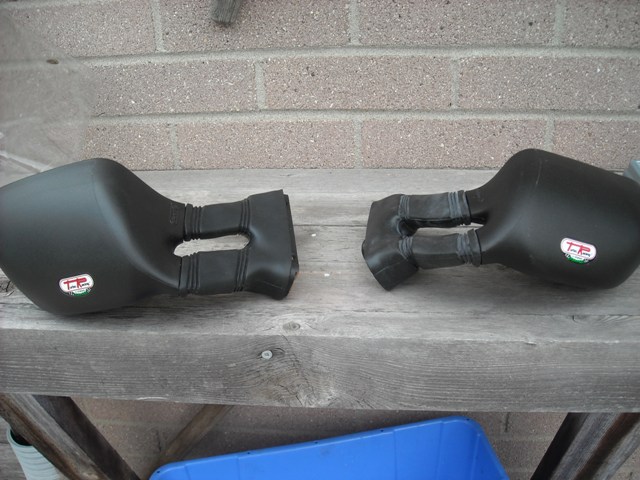

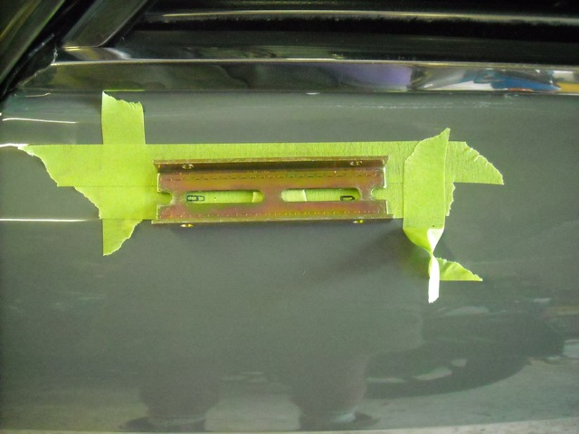

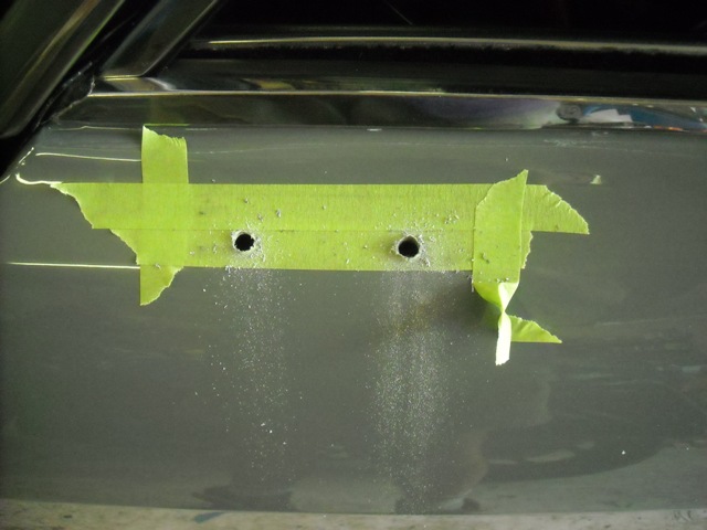

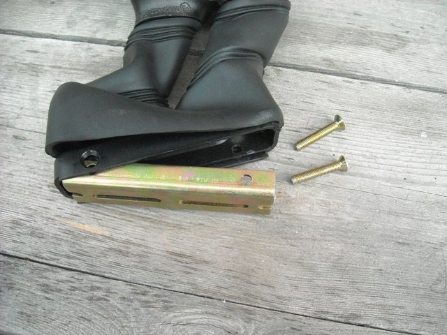

I am very impressed with the quality and design of these mirrors so I thought I would add some close ups and how to info.

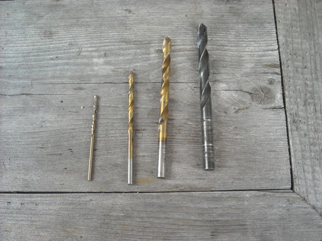

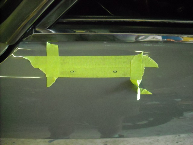

Save yourself the heartache and repairs and just start with a small drill and build up to the final 5/16th drill.
You may even be able to use your existing holes, there is lots of wiggle room on the base plate.
Also make sure you use the plastic insert plugs, they help reduce the vibration.
Vibration is no more than the inside rear view mirror and there is no whistling.
Whoa! After years? Decades? I finally see a mirror that really looks and performs great. Most mirrors offered by MSA and others are crap. Think I got mine at Checkers (O'Rielly) after I had the car repainted...they are less than adequate to lousy.
Comment: It would seem as bolts through the door with backing plate like OEM would be way stronger. I can see bumping into it (me or some other bozo) and it rips out. A couple of sheet metal screws do not hold much. I know it's a PITA to take apart the door panels and stuff and deal with the backing plate that you can only really install by feel. Comments?
