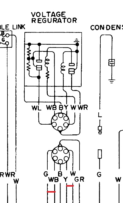

SteveJ Posted March 10, 2013 Share #10 Posted March 10, 2013 Okay, let's move away from pin numbers and focus on wire colors. It took me a while, but I think I have it figured out. The White & Yellow wires should be jumpered together. The Green & White/Black wires should be jumpered together. The Black wire doesn't need to be jumpered. The Green/Red wire doesn't need to be jumpered. See if that works for you. Link to comment https://www.classiczcars.com/topic/45973-60-amp-swape-not-charging-battery/#findComment-417421 Share on other sites More sharing options...
hotflames280z Posted March 11, 2013 Author Share #11 Posted March 11, 2013 Thank you SteveJ. I hooked the wires like u mentioned and almost everything worked, that is the good news is that the alternator is good and charging the battery. No sparks or smoke naywhere that I can see. Even the lights,wipers worked alot better. Ok,nuff of that! when I turned the key to turn off the motor , the motor would not turn off. According to the info I got on the swape looks like I need to ge t a diode from Radio Shack and solder it to the T connection. Not a problems as long as it works. Thanks again for your help. Link to comment https://www.classiczcars.com/topic/45973-60-amp-swape-not-charging-battery/#findComment-417449 Share on other sites More sharing options...
