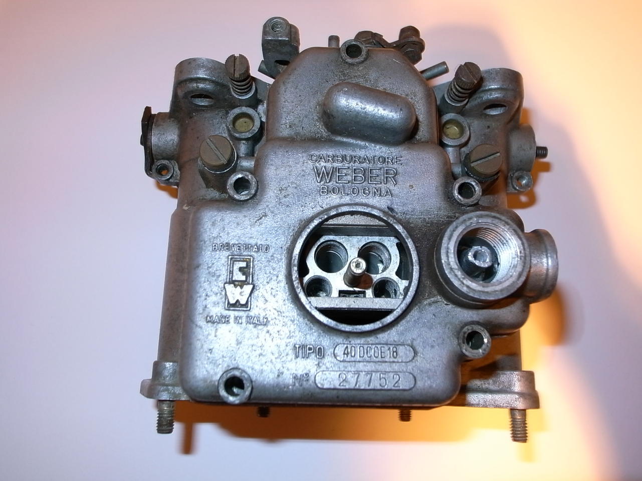

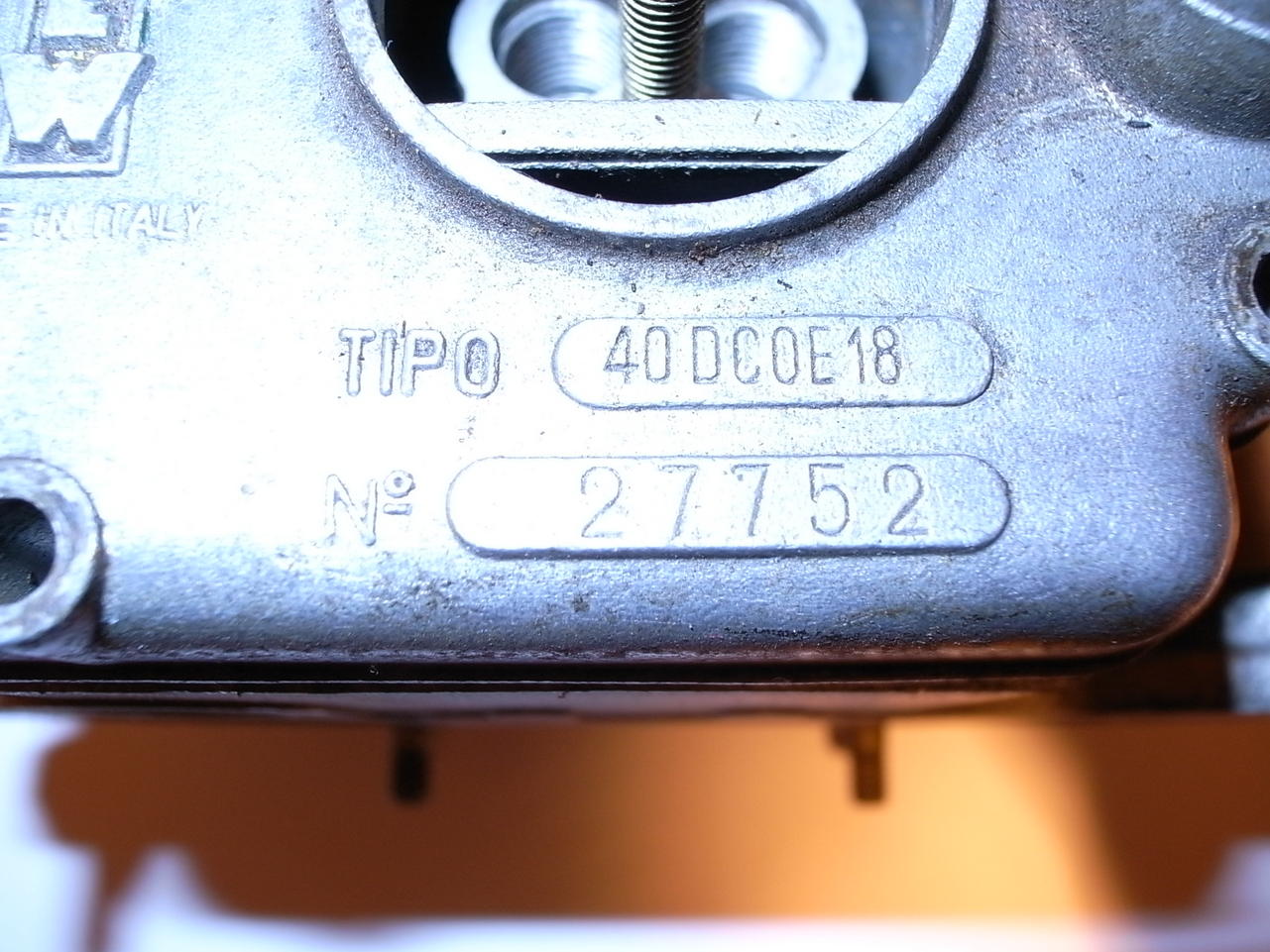

OK, I managed to find my box of used carbs, and I selected a single 40DCOE-18 that might be a good candidate.
The manufacturing date is a little later than yours ( mine is no.27752 ) so it's not really a perfect match. However, theoretically any early 40DCOE-18 should match up with another early 40DCOE-18 as far as circuits and internals etc, so it should work.
