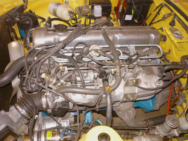

Here are some pictures from my 11/75 - 76 280. Might help.
Sorry Cappy, but I think you're wrong. There's at least one ring terminal ground in the FI harness, at least on my ZX. Kinda hard to see in Mgood's pictures, it goes underneath the hold-down strap that holds the EFI harness stable (circled) Do you see it now?

AFAIK, there are those two ring terminals; one on the AFM (case-to-chassis), an the one on the harness clamp (main FI ground), on the intake. The others are bullet connectors to sensors and other small items.

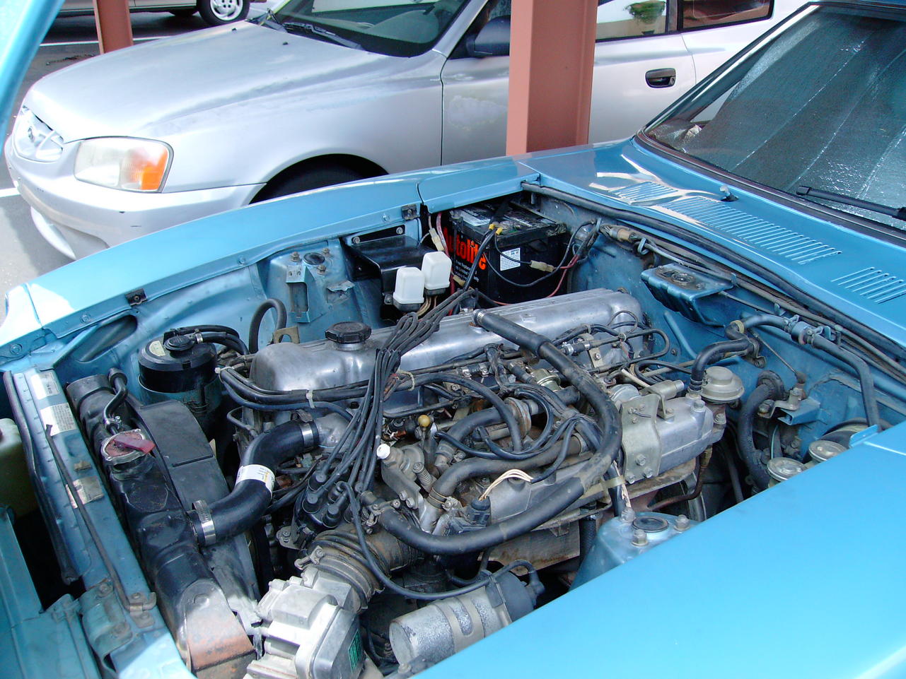

I believe the temp sensor was the culprit, the bullet connectors had several spots where the insulation was broken and bare wire was visible, the wire at the connectors was also very slightly exposed and nasty looking, so I put in new ones on the temp sensor and the thermotine and hopefully that will fix the issue, we'll see. The AFM has the ground ring in place and there is the wire to - battery in place which I'll double check later today. I am amazed at the knowledge of the members here and always get answers to my sometimes silly questions. Thanks to all of you. You can sorta see the battery connections in this pic. This was before I unwrapped the FI harness.
Haha! Me wrong? Completely plausible. Probable even! mgood's photos clearly show ring terminal grounds. :embarrass:

In mgoods photos, there are what appears to be TWO wiring harnesses going under that cable clamp near the AAR. There is a large diameter harness (which is clearly the EFI harness), and there's a small (1/2 inch) harness laying on top of it.
That ground ring terminal connection actually comes out of the SMALL harness, not the EFI harness. So where does that other harness go? Does it actually tie into the large EFI harness somewhere out of frame, or is it in fact part of the engine bay harness and NOT the EFI harness.
And what about the one at the AFM? Does that ring terminal actually emanate from the EFI harness, or does it come out of the bay harness?
