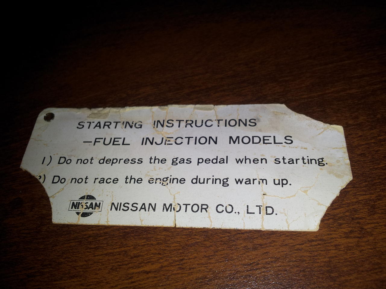

hr369 Posted March 18, 2013 Share #15 Posted March 18, 2013 I wonder how much of this "won't start" can be attributed to pumping the gas pedal? Link to comment https://www.classiczcars.com/topic/46042-78-z-will-not-start/?page=2#findComment-418218 Share on other sites More sharing options...
AndysPlit Posted March 18, 2013 Author Share #16 Posted March 18, 2013 I wonder how much of this "won't start" can be attributed to pumping the gas pedal? Tried that.... Link to comment https://www.classiczcars.com/topic/46042-78-z-will-not-start/?page=2#findComment-418219 Share on other sites More sharing options...

hr369 Posted March 19, 2013 Share #19 Posted March 19, 2013 Tried that.... Yup, figured that. Don't do that with your 78. Its fuel injected. In the sun visor of my 78 was a card from datsun that said..... Link to comment https://www.classiczcars.com/topic/46042-78-z-will-not-start/?page=2#findComment-418300 Share on other sites More sharing options...
AndysPlit Posted March 19, 2013 Author Share #20 Posted March 19, 2013 Yup, figured that. Don't do that with your 78. Its fuel injected. In the sun visor of my 78 was a card from datsun that said..... [ATTACH=CONFIG]61923[/ATTACH] But, I only tried it when things were desperate Link to comment https://www.classiczcars.com/topic/46042-78-z-will-not-start/?page=2#findComment-418334 Share on other sites More sharing options...
