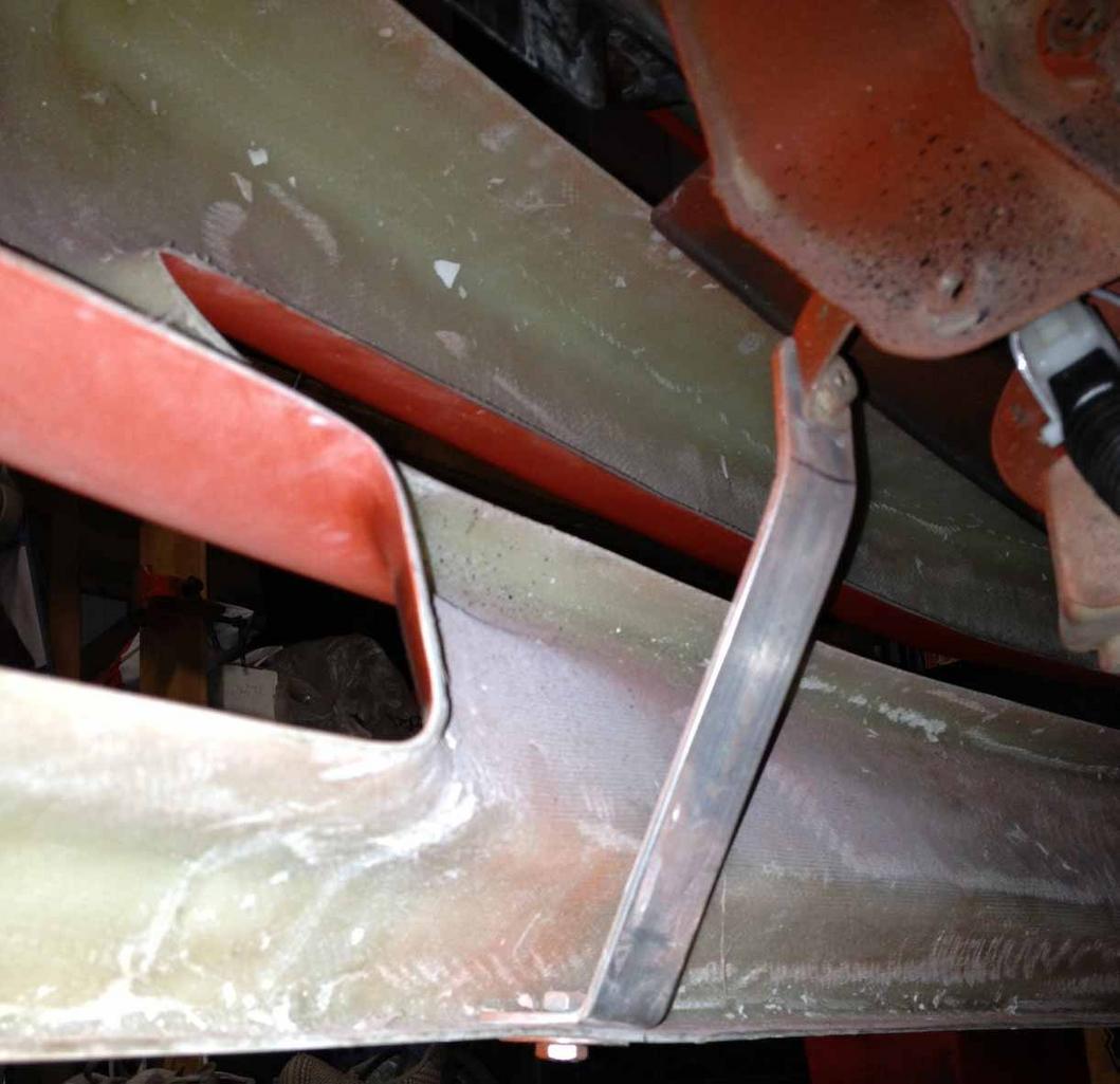

Not sure where everybody is at that has installed the MSA body kits; however, I found a post that suggested using (3) 10mm bolts on each side of the front air dam and screws where the part meets the wheel wells.
I am going to try this and see how it holds.
daroom, what did you attached the aluminum strap to? Also, did you fill in gaps where the air dam meets the car? If so what did you use and have you seen cracking of the paint at that area? Did you use sheet metal screws at the wheel well area and if so are they visable?
