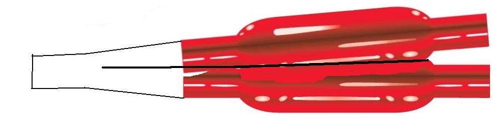

I considered something like your idea. It was to get two glasspack mufflers and using a bandsaw, cutting a slice off the side of each and then welding them back together. the slices would have to be thick enough so when you put it back together, the outlets are at the desired spacing (about half the spacing, I'd say.) then you can extend the outlets with a plain tube or a fancy chromed tip. the fun part would be joining the inlets so you can fit it to your exhaust system. You could add some baffles, or rather, some half-baffles, so add to the muffling capacity.

A couple quick graphics of the two'siamesed glasspacks' idea, the heavy line is about where the cut is.
