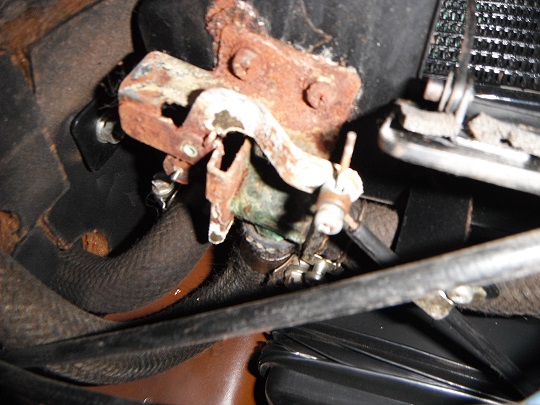

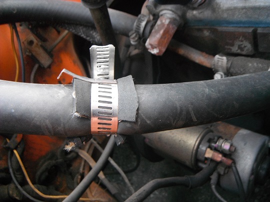

Stanley Posted April 14, 2013 Share #5 Posted April 14, 2013 Read a post here that said if the windshield fogs up it means the core's leaking, but I don't really know. Here's a shot on the corroded valve on my 240 - don't know if the 280 one is similar. Also a shot of my heater loop, with a restrictor (hose clamp with piece of radiator hose for a cushion) I put a couple days ago. The restrictor cuts down the amount of hot coolant recycled to maybe 25% of what it would be without it. Just temporary. Don't know if this helps. Link to comment https://www.classiczcars.com/topic/46266-heater-issues-coolant-leak-and-a-charging-issue-please-help-rally-coming-up/#findComment-420543 Share on other sites More sharing options...
bartsscooterservice Posted April 15, 2013 Share #6 Posted April 15, 2013 Mine was leaking to, but it was the core, and my dad soldered it. But if the valve is leaking, look for another one on a yunkjard maybe? Don't know if there are any around with Z's in your area. My valve was stuck to, but sprayed it with wd40 and gently loosened it up, it still holds I think if I would have ripped it open without using some lube, it would have damaged the seal. Link to comment https://www.classiczcars.com/topic/46266-heater-issues-coolant-leak-and-a-charging-issue-please-help-rally-coming-up/#findComment-420583 Share on other sites More sharing options...
